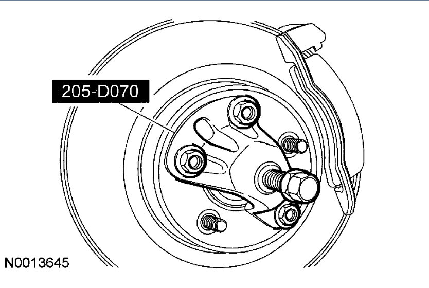

Did it break inside the hub? See pic 1 below. Is that the section the broke? If it is, I use an air hammer to remove it. I center the tool on the axle, and it always comes out.

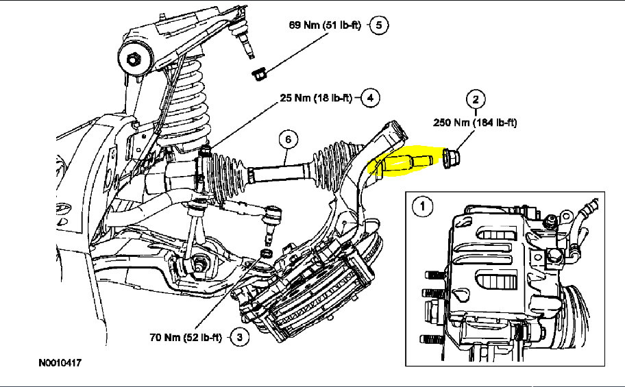

If you don't have a hammer, then we need to get a special puller. Most parts stores have them and will lend them out. See pic 2.
Let me know if either of these help.
