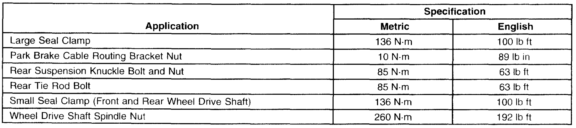

Torque spec on front CV axle bolt.
Feb 5, 2017 at 7:24 PM
SATURNTECH9
  • 30,869 POSTS
Make sure you torque it down before putting the car back down on the ground or you could ruin the bearing. Here is a video to help with the torque specs below.
