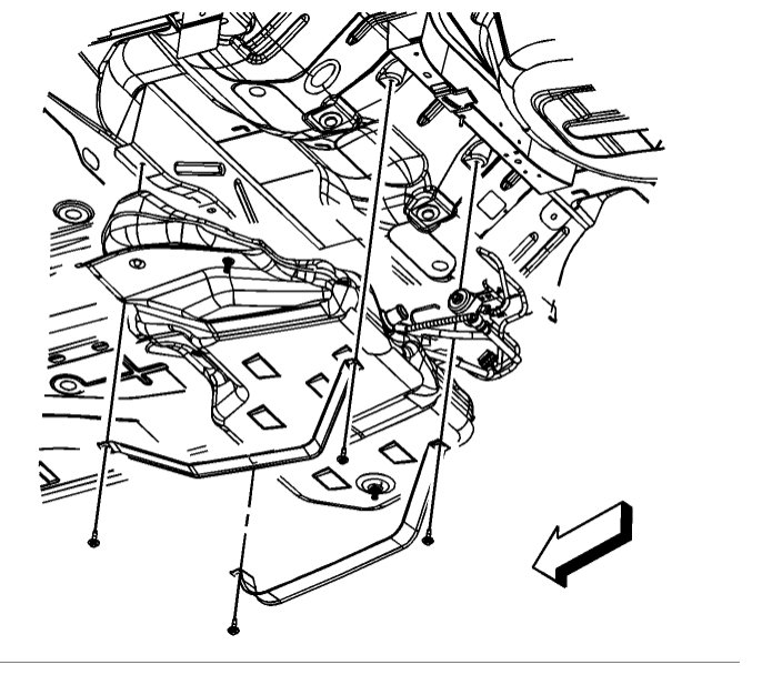

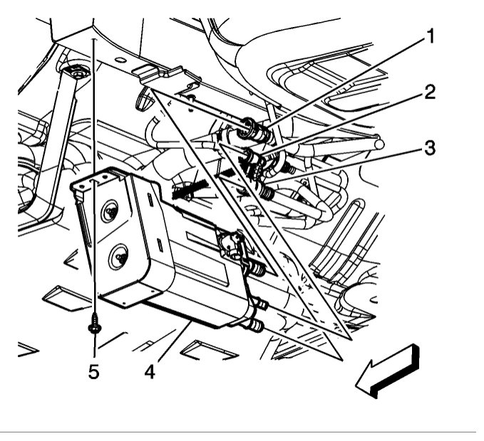

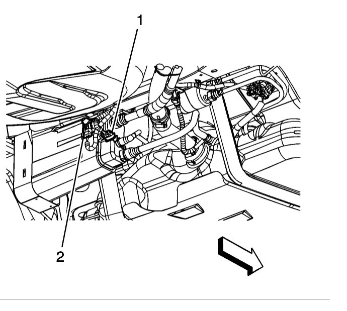

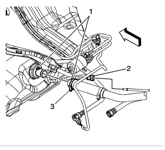

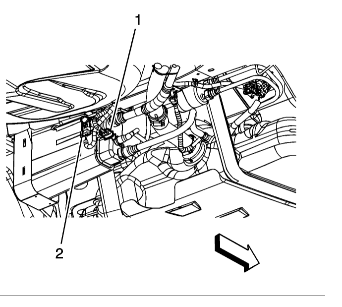

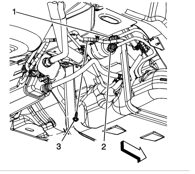

It sounds like you have a fuel pump going out which is common. Here is a guide to show you how to test it.
and
https://www.2carpros.com/articles/engine-stalls

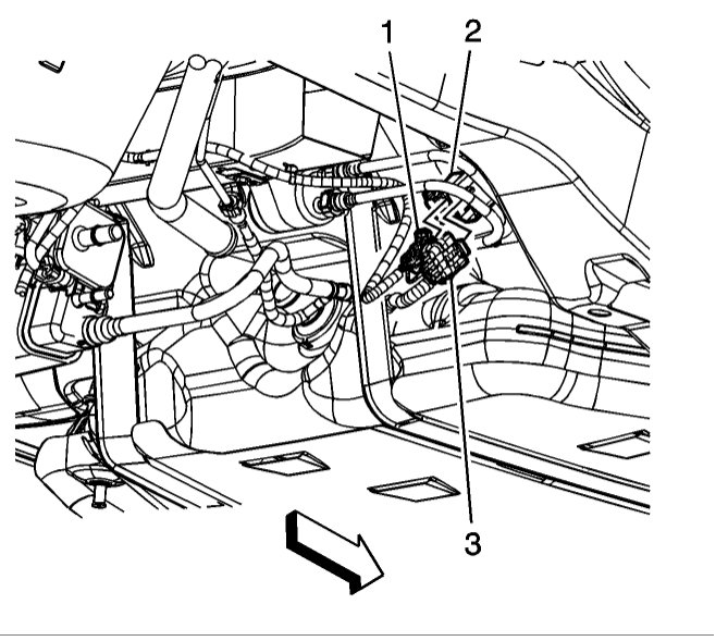

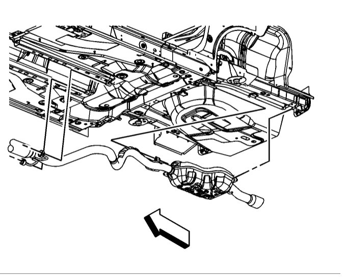

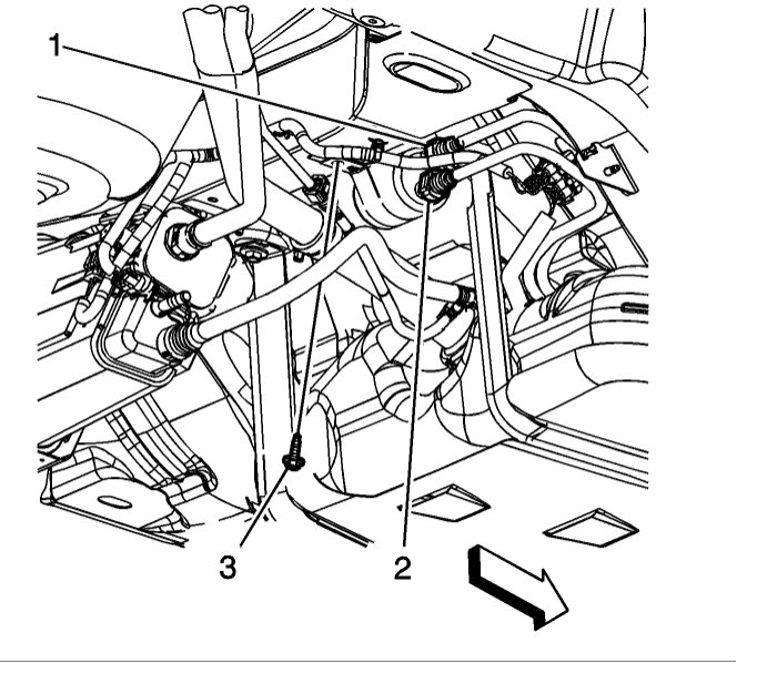

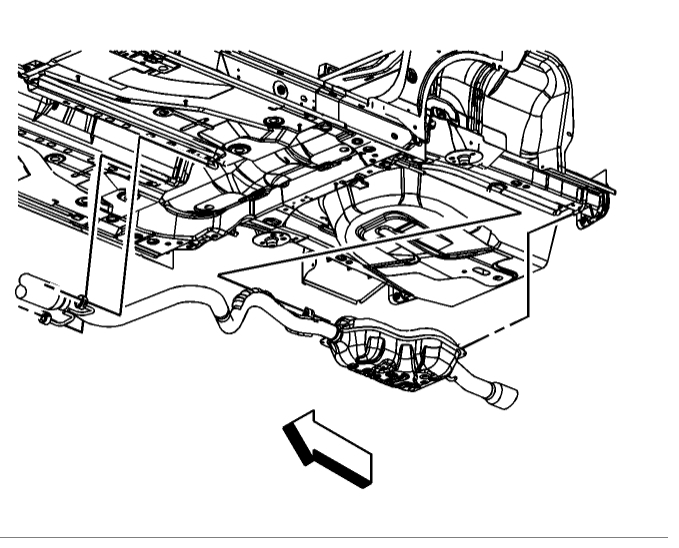

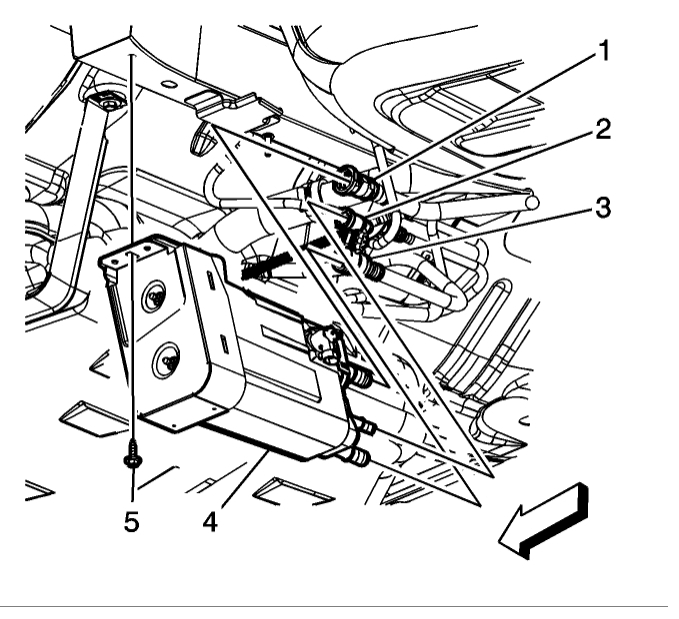

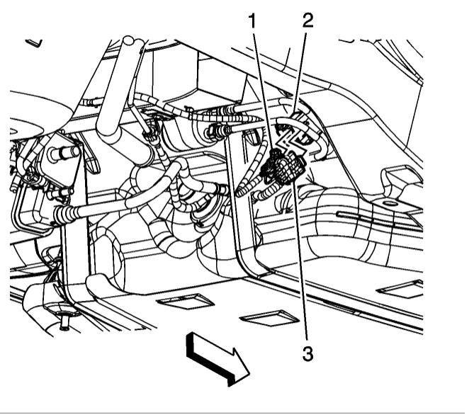

Here are some diagrams that will help you change out the fuel pump.
