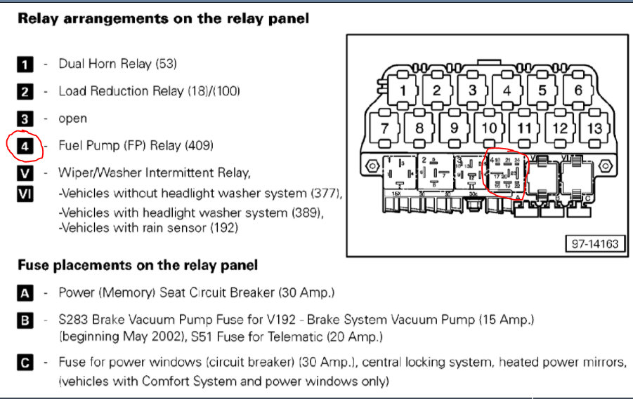

Here is the relay information you requested. The fuel pump relay is located on the 4th position on the relay panel. Here is a tutorial on how to test a relay:
I've attached a picture below of the fuel pump relay location and circled in red. Hope this helps and thanks for using 2CarPros.
