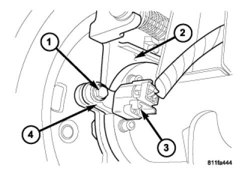

Front speed sensor removal
REMOVAL
pic 1
1. Remove the front rotor.
2. Remove the wheel speed sensor mounting bolt (1) from the hub (3).
3. Remove the wheel speed sensor (2) from the hub (3).
4. Remove the wiring from the clips and disconnect the electrical connector.
______________________________________
Front Install
Pic 1
1. Install the wiring to the clips and Reconnect the electrical connector.
2. Install the wheel speed sensor (2) to the hub (3).
3. Install the wheel speed sensor mounting bolt (1) to the hub (3). Tighten the bolt to 21 Nm (190 in. lbs.).
4. Install the front rotor and brake caliper assembly.

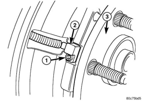

Rear Removal
REMOVAL
pic 2
1. Raise the vehicle on a hoist.
2. Disconnect the wheel speed sensor electrical connector (3).
3. Remove the mounting bolt (1) from the sensor (4).
4. Remove the sensor (4) from the brake caliper adapter (2).
Rear Install
Pic 2
1. Insert the wheel speed sensor (4) in the brake caliper adapter (2).
2. Install the sensor mounting bolt (1) and tighten to 24 Nm (200 in. lbs.).
3. Reconnect the electrical wiring connector (3) to the sensor (4).
4. Lower the vehicle.
