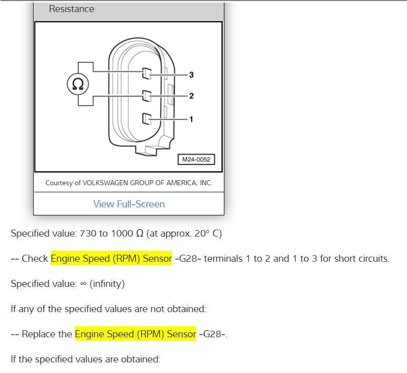

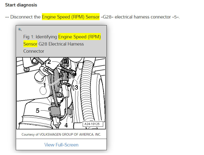

This sounds like you need to recheck the sensor and connector you could have a defective sensor here is the location. It is called an engine RPM sensor. Check out the diagrams (Below). Please let us know what happens.
