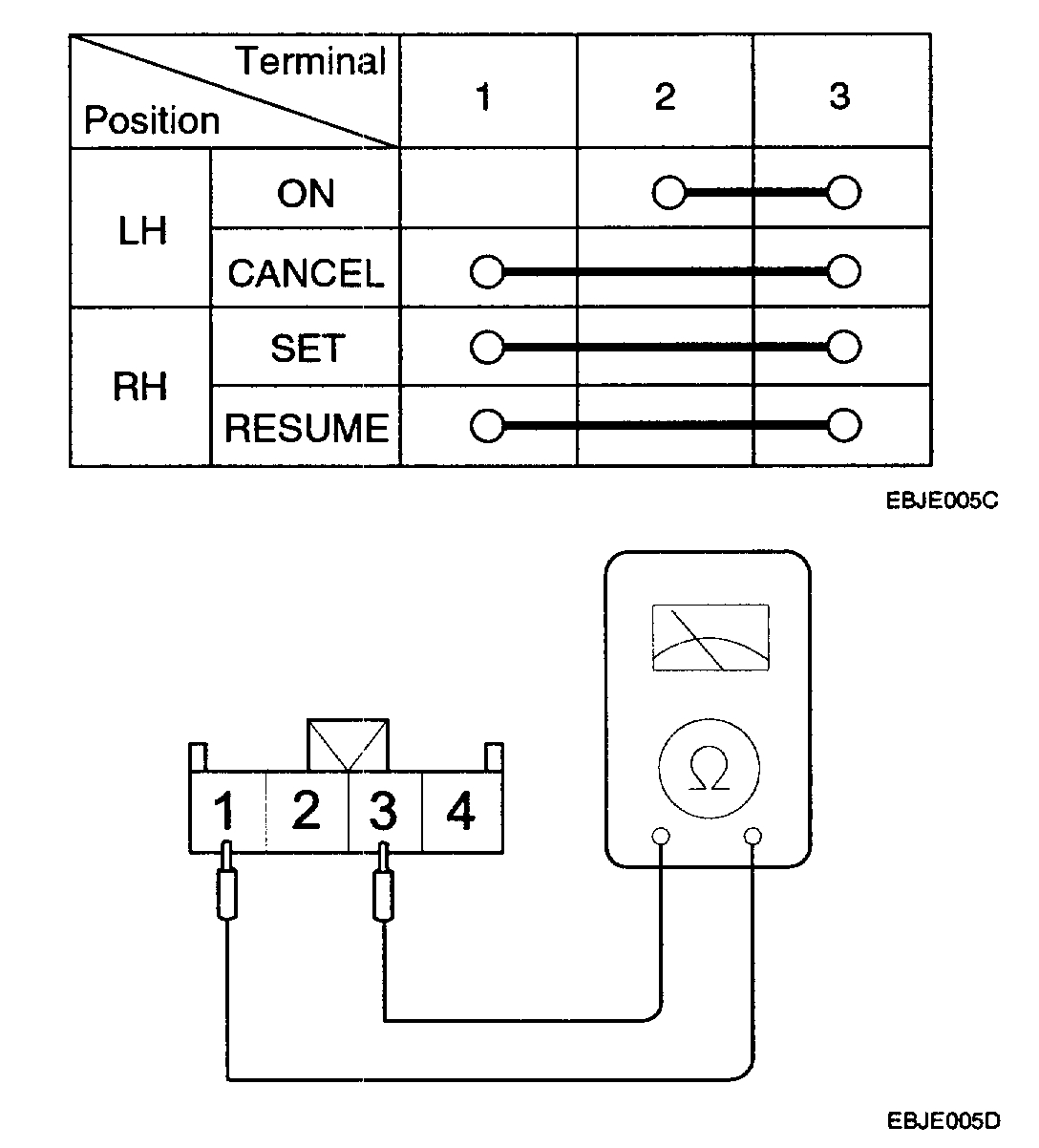

CRUISE CONTROL MAIN SWITCH
1. Operate the switch and check for continuity between the terminals.
pic 1
2. If continuity is not as specified, replace the switch.

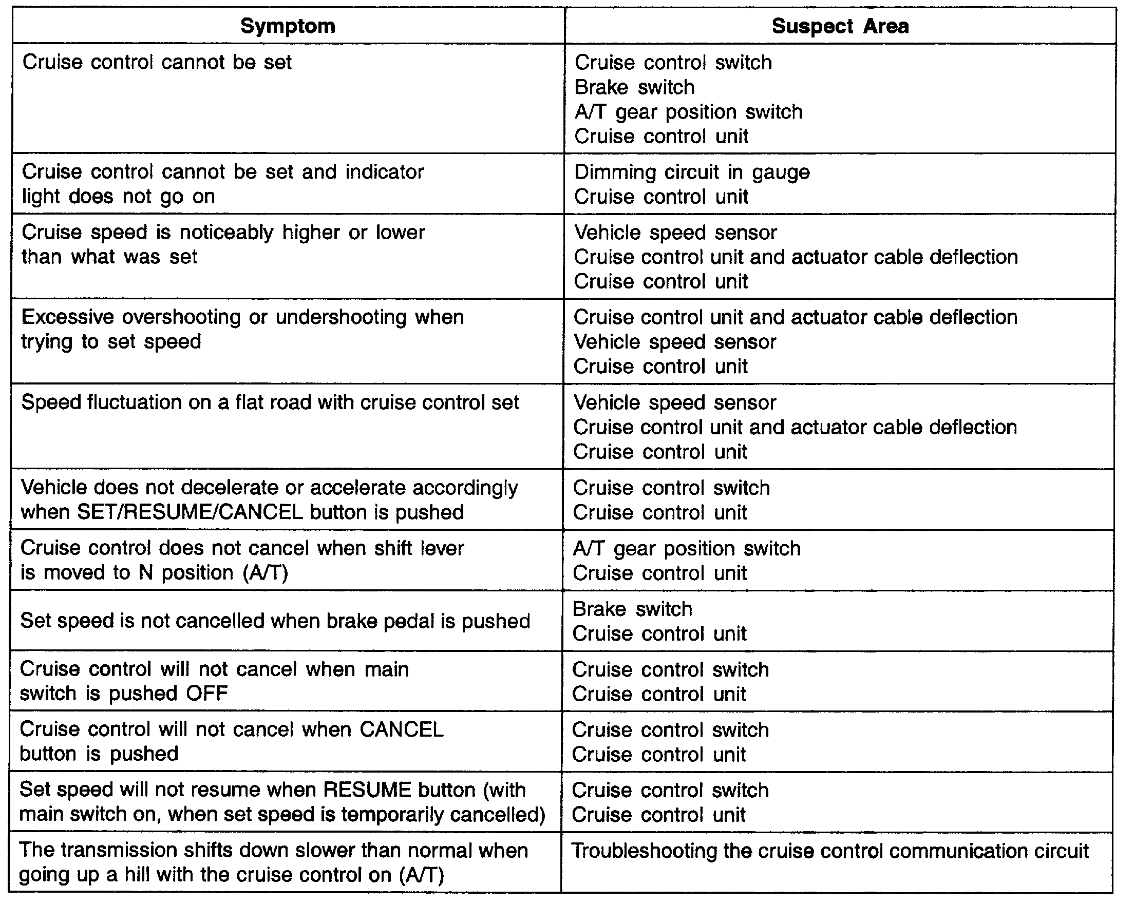

TROUBLESHOOTING
see pic 2
NOTE: Before troubleshooting:
- Check the No.4 (10 A), No.14 (10 A), No.19 (10 A) fuse In the passenger compartment relay box.
- Check ECU #3 (10 A) fuse in the engine compartment relay box.
- Check that the horn sounds.
- Check the tachometer to see if it works properly
