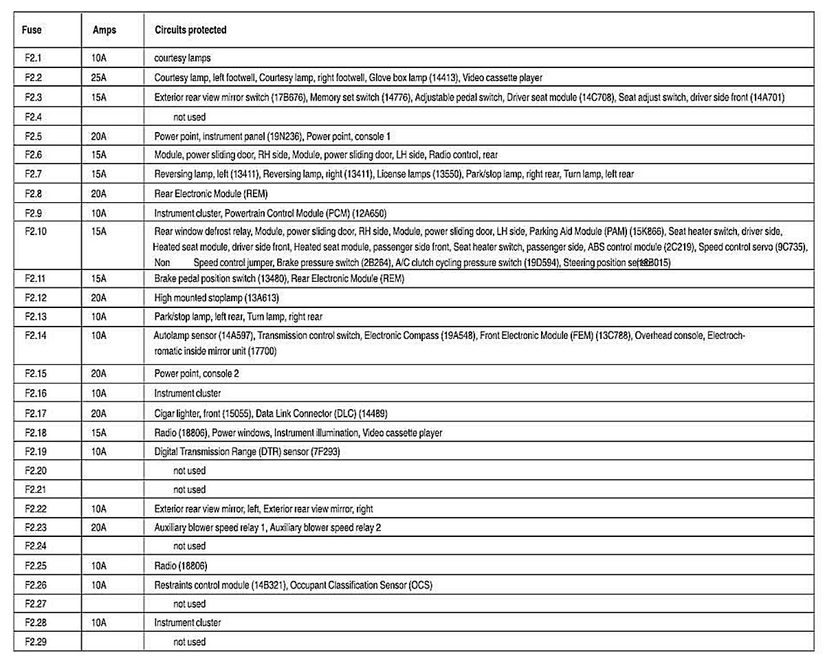

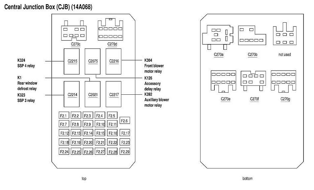

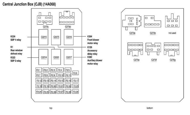

Hi and thanks for using 2CarPros.com. The fuse you are looking for is F2-10 located in the central junction box. I have attached pics of the box and a fuse allocation list.
The third picture is the location of the junction box.

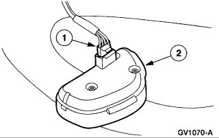

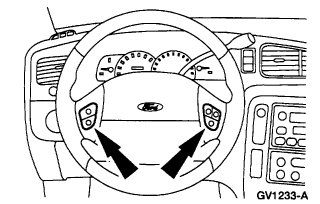

If the fuse is good, I would suggest checking the switch for power. Here are directions for removing and replacing the switch in case you need them. Pictures 3 and 4 are related to these directions.
Removal:
Disconnect the battery ground cable.
Release the speed control actuator switch from the steering wheel.
Caution: When separating the speed control actuator switch from the steering wheel, it is necessary to take precautions not to damage the steering wheel.
Note: Standard actuator switch shown, optional actuator switch similar.
Remove the speed control actuator switch.
1 Disconnect the speed control actuator switch electrical connector.
2 Remove the speed control actuator switch.
Installation:
To install, reverse the removal procedure.

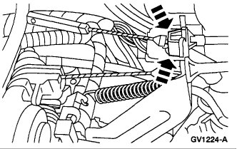

Also check the speed control servo cable. Here are directions for removing and replacing plus picture 5 is related to these directions.
SERVICE AND REPAIR
REMOVAL
Remove the speed control servo.
Remove the speed control actuator cable from the throttle bracket by squeezing the locking ears.
INSTALLATION
NOTE: Make sure that the speed control cable does not interfere with throttle travel.
