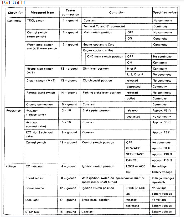

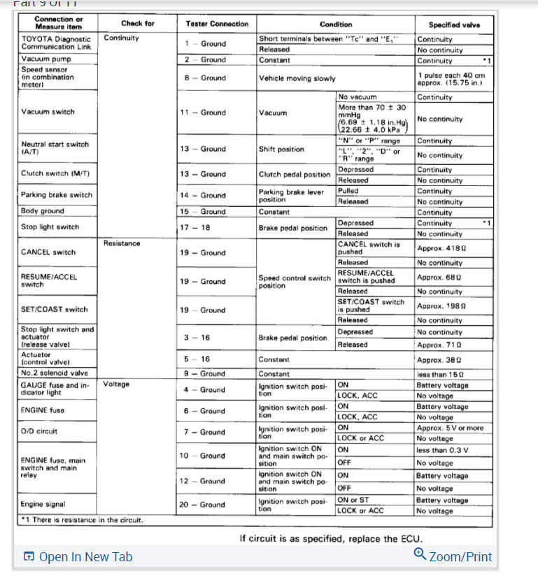

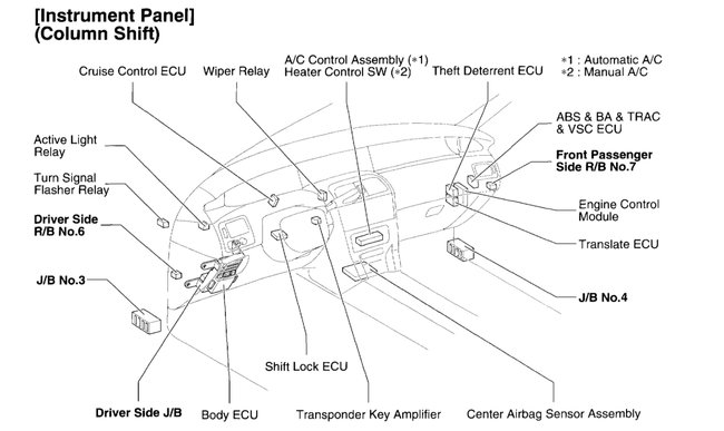

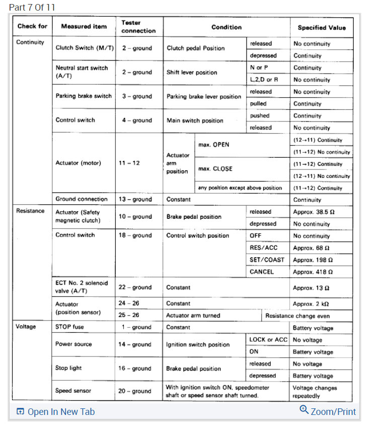

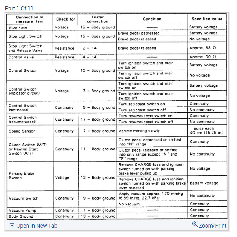

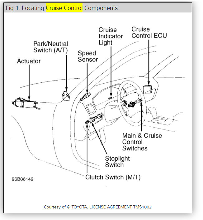

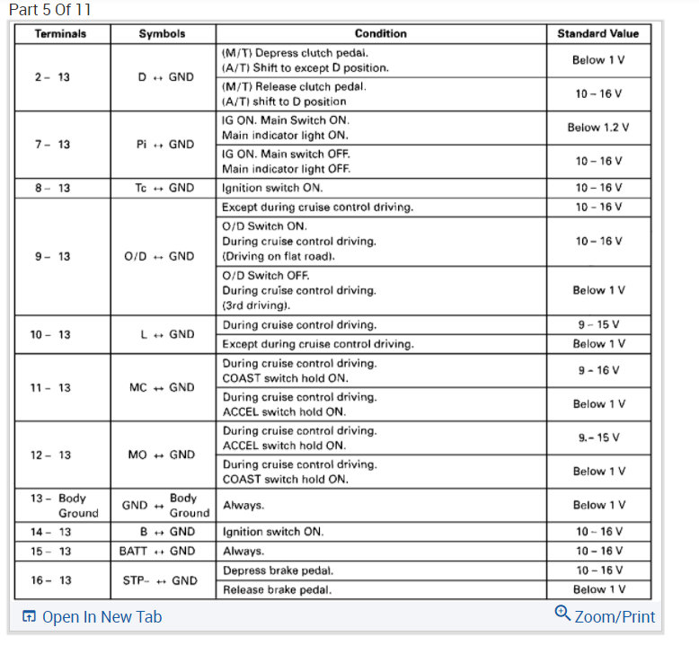

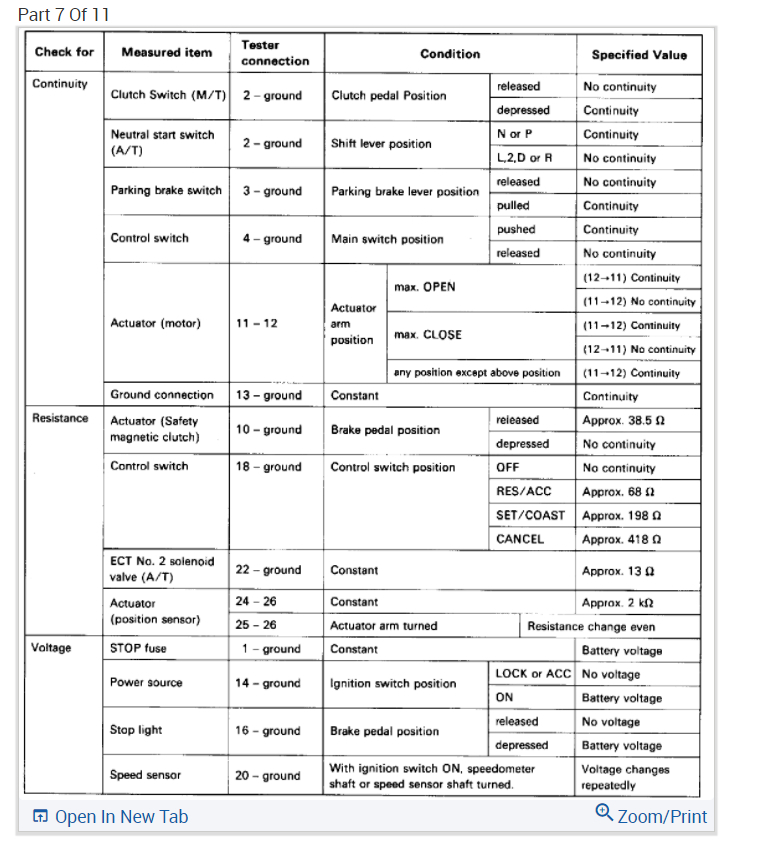

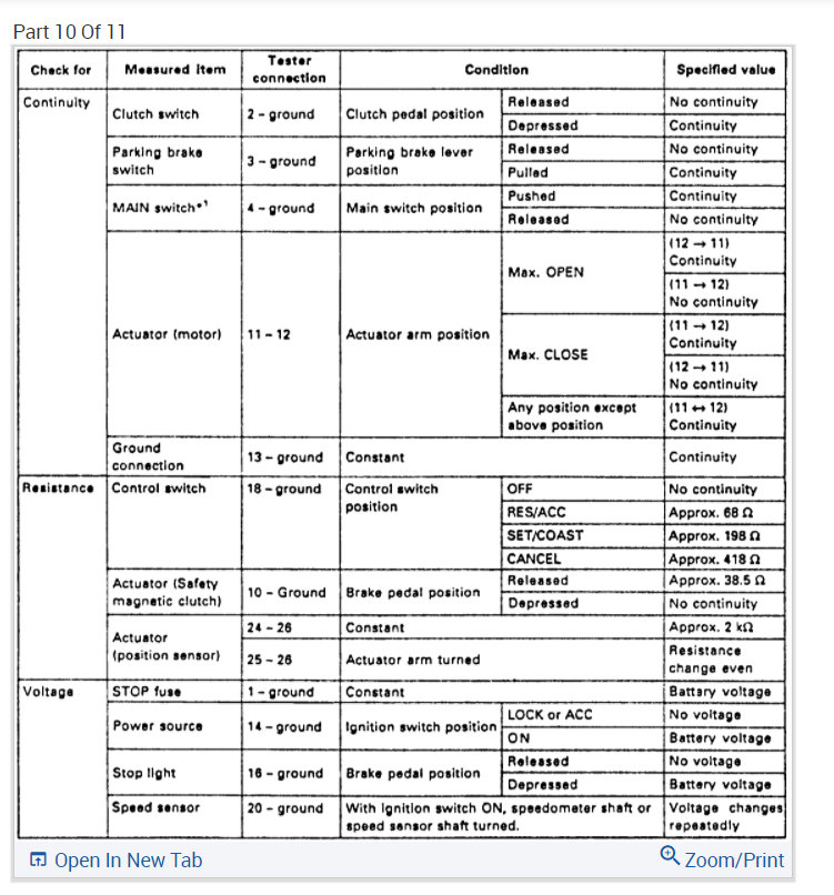

Cruise control works an doesn't work intermittently. When it doesn't want to work, the cruise control indicator light flashes 5 times and it will not come back on until you turn the ignition off and restart the engine, and even then you have 50/50 chance it will work properly. Note: It seems to not work at all only on the first try every time. If it works the very first time after starting the engine, it usually works from there on out. Could someone help please?
