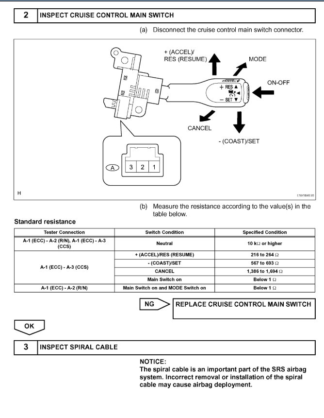

This could be a clock spring issue but let's clarify what the issue is. We you press the On Off button, is there an indicator that turns on like normal and it just doesn't set the speed? Or does the system not even turn on?
The next thing we need to do is check for codes. More than likely you have a code indicating what the issue is.

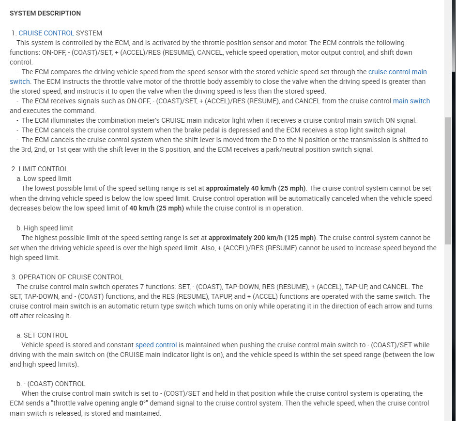

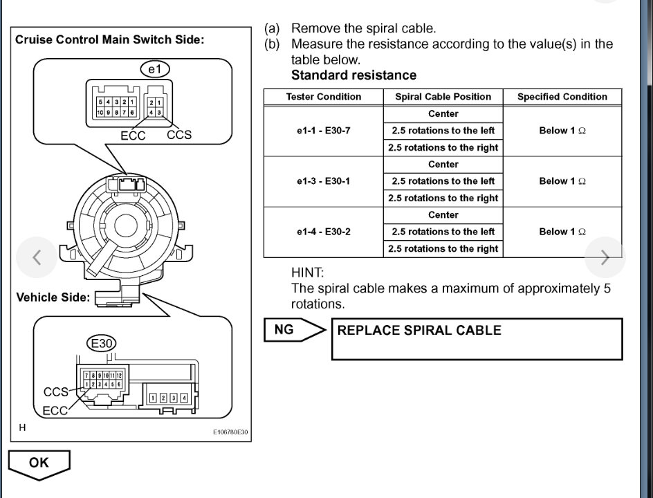

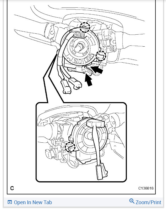

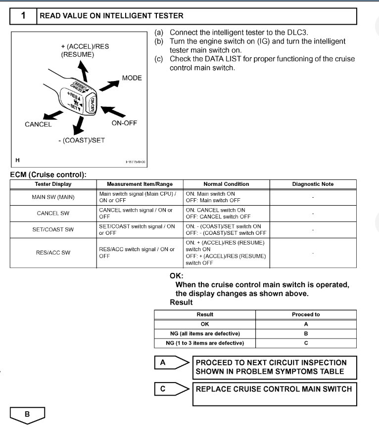

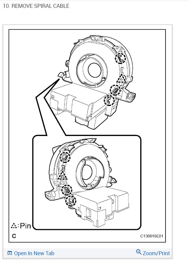

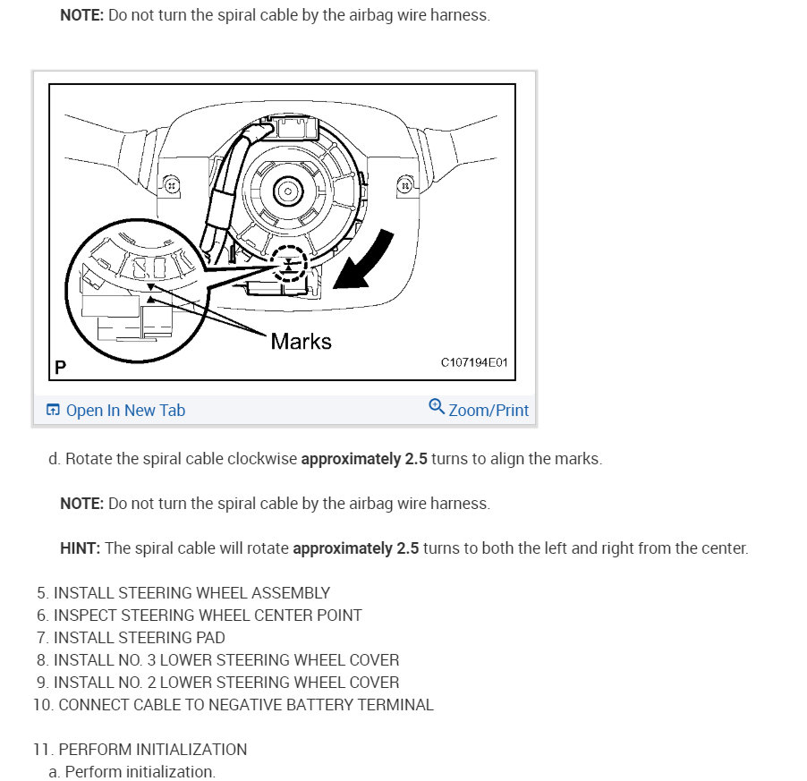

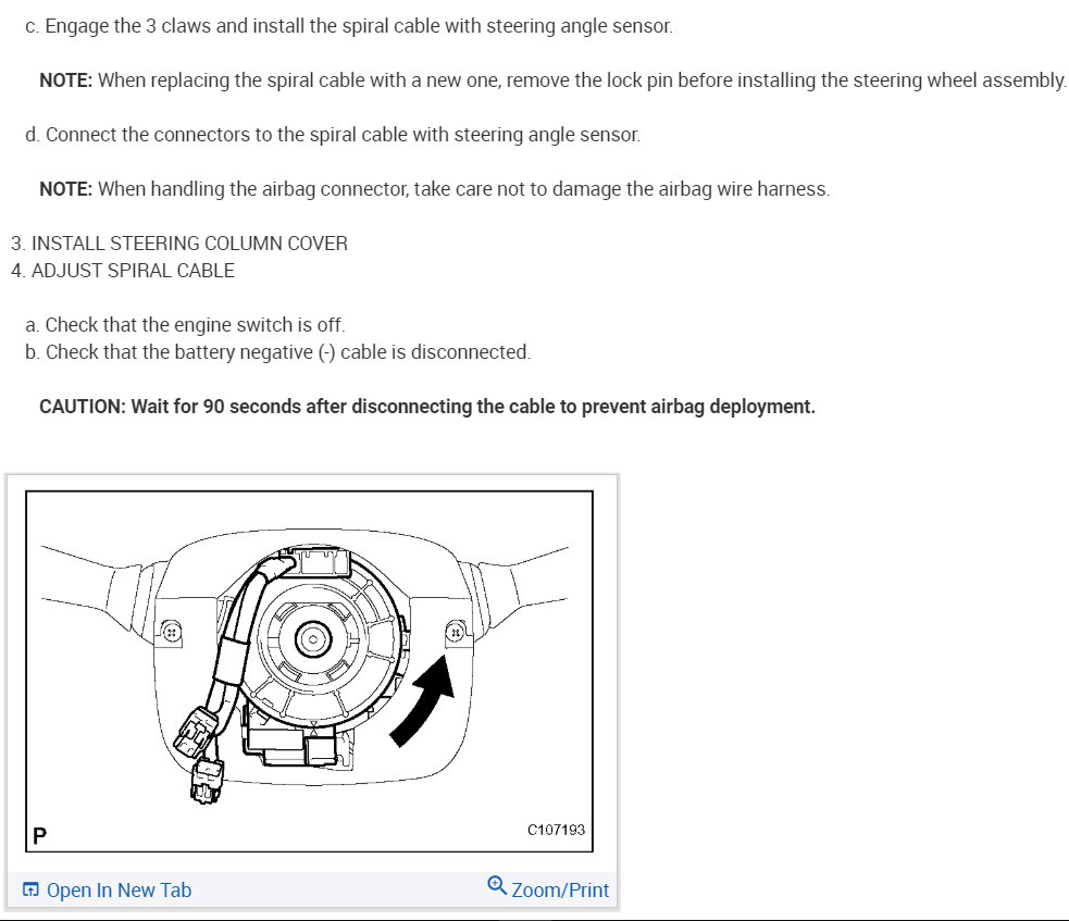

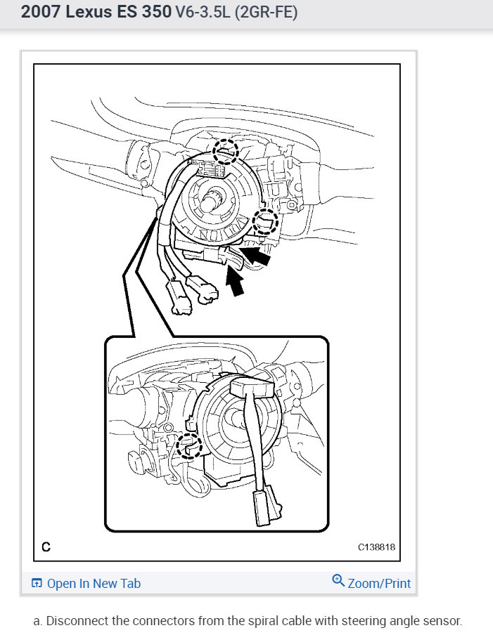

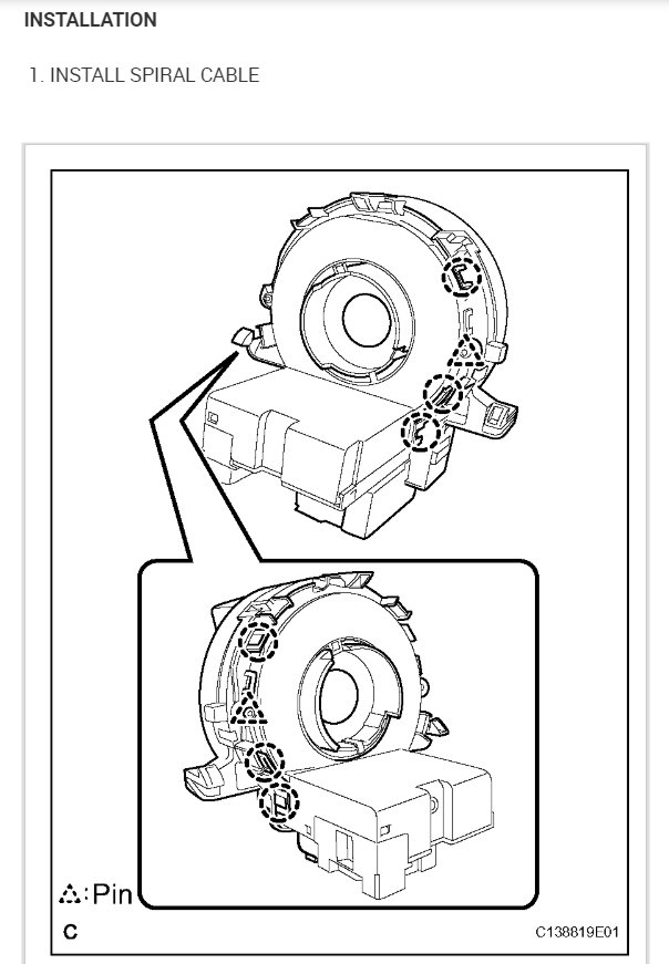

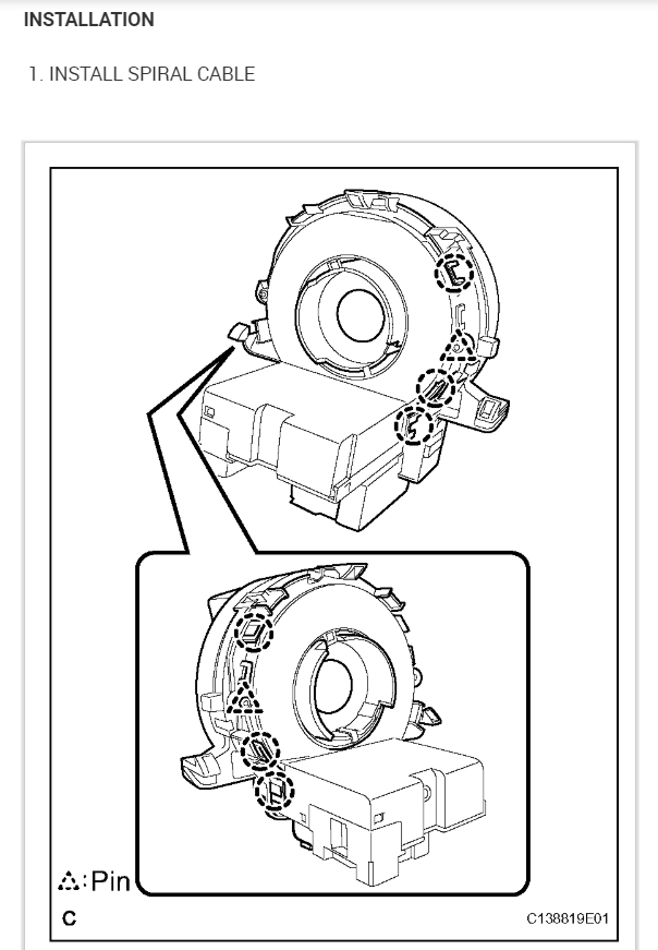

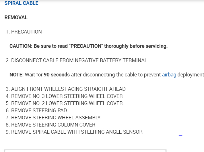

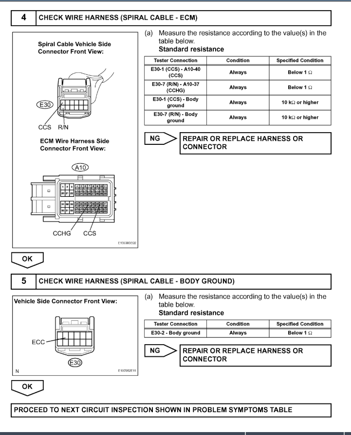

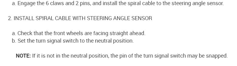

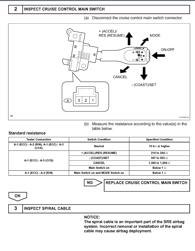

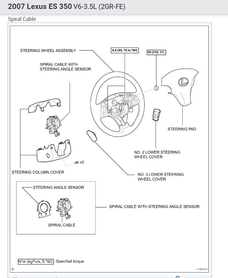

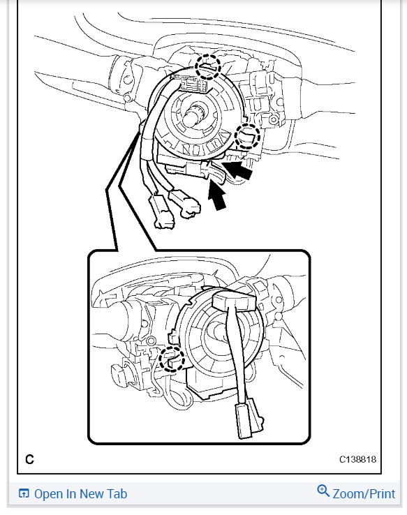

Yes, the clock springs go out causing this issue all the time. Here is a guide to help you step by step with instructions in the diagrams below to show you how on your car:
https://www.2carpros.com/articles/steering-wheel-clock-spring-removal
and
https://www.2carpros.com/articles/steering-wheel-removal
Check out the diagrams (below). Please let us know if you need anything else to get the problem fixed.

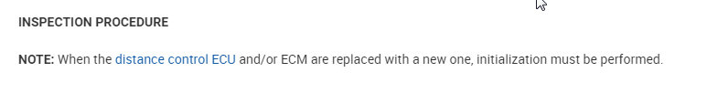

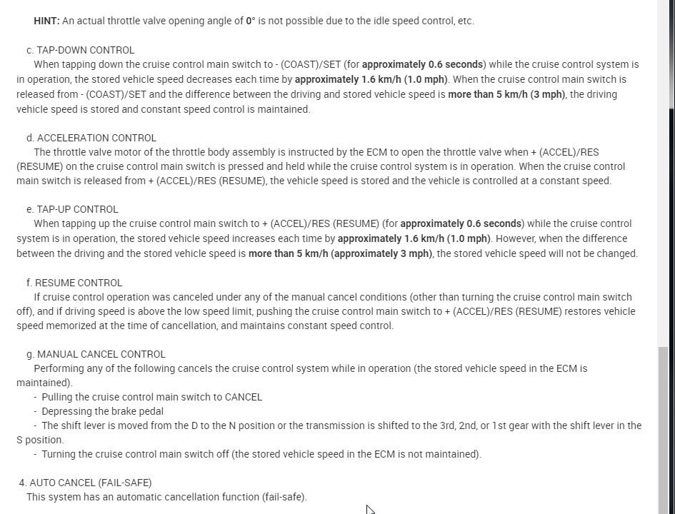

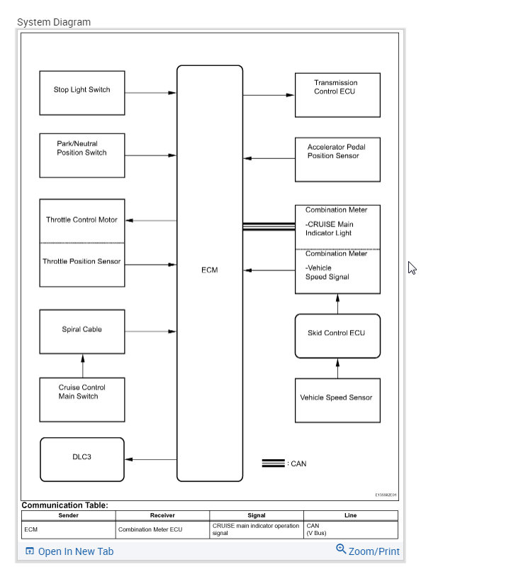

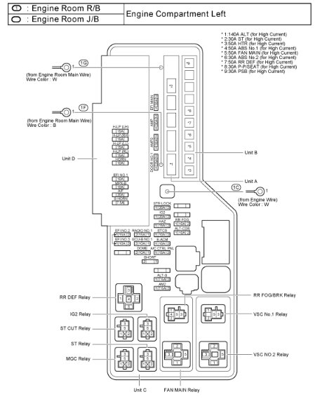

It could be history trouble in the ECU, The cruise control will not function with emission code is present in the module. Have some with a diagnostic tool to clear all the codes in all the modules. Make sure when you set cruise control, You push the button at the end and press down on the stalk to set. I would start there and than check fuses and relays. I am sending links below for fuse box details. Please let us know if this information helped and what fixed it.

Do you have any warning lights on? Also as stated earlier, do a system scan for codes. If you have a faulty brake switch then that will cause the cruise control to not operate.
If you have the dynamic cruise control system with radar where the speed adapts to the vehicle in front of you then I would ask if you your vehicle has been in an accident in the front? If it has and you had a bumper repair then the millimeter wave radar would need to be calibrated. If you had the windshield replaced you would also need the camera calibrated. Very sensitive components on these vehicles. So a full system scan is needed to see what is happening.
