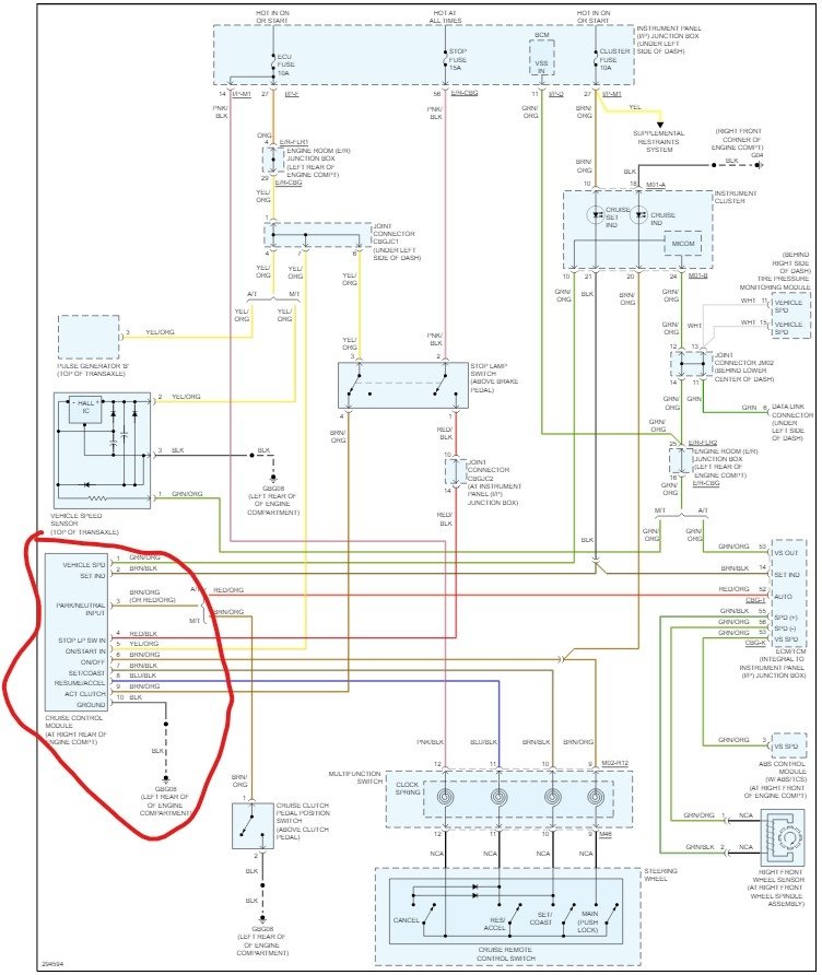

When replacing the cruise control module with a used unit does it need to be programmed?
2008 KIA SPECTRA
160,000 MILES • 2.0L • 4 CYL • 2WD • MANUAL
RD66
  • 61 POSTS
Does a used cruise control module need to be reprogrammed to your VIN like an ECM?
Apr 28, 2022 at 11:24 AM
STEVE W.
  • 15,113 POSTS
No, it is not an active control module on that car that needs programming. The only things it gets from the ECM are the switch inputs for the neutral switch and the speed input from a wheel sensor.
