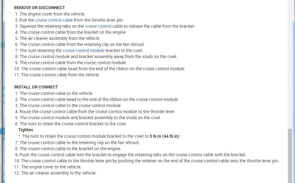

Can you please tell me where I would find the servo? I want to replace it? TIA
May 7, 2021 at 10:35 AM

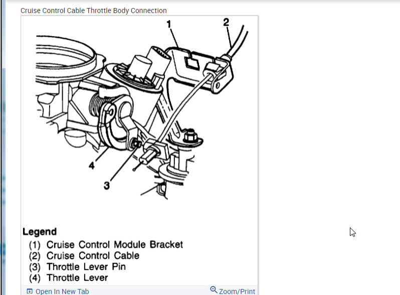

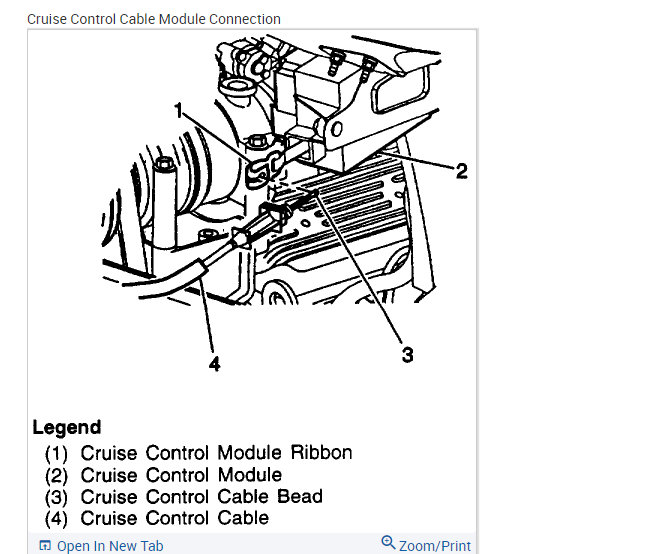

Please find the info below on the cruise control. It appears they call the servo the module but it should be easy to access.
Please let us know if you have other questions. Thanks
