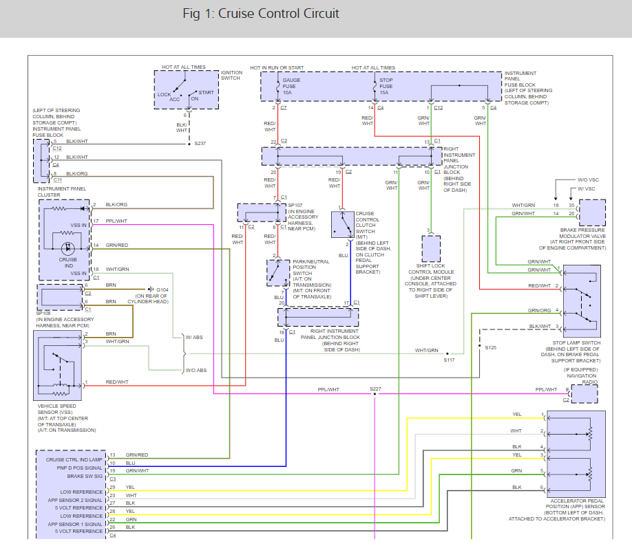

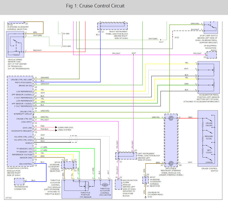

Cruise control will not engage. The problem first started kicking out while going down the road or start climbing a small hill. I replaced the Foot brake switch that did not help I replaced the steering wheel lever switch that did not solve the problem. I ran a jumper wire from the horn module to the fan module under the hood now it don't get hot the cruise light on the dash comes on but will engage. All fuses have been replaced.
Where do i search next.
