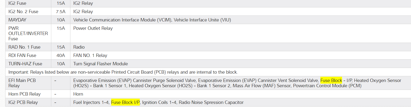

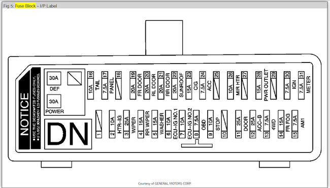

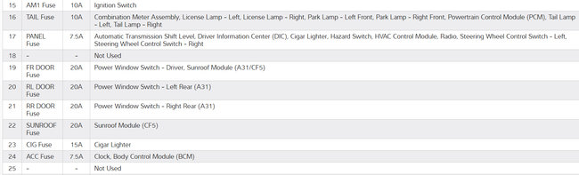

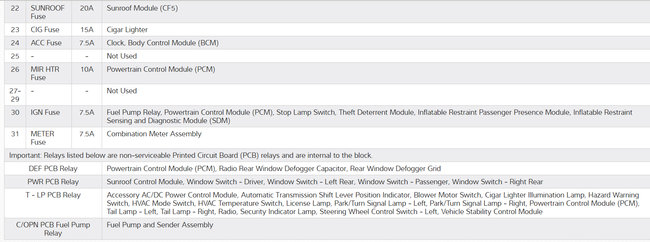

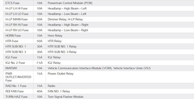

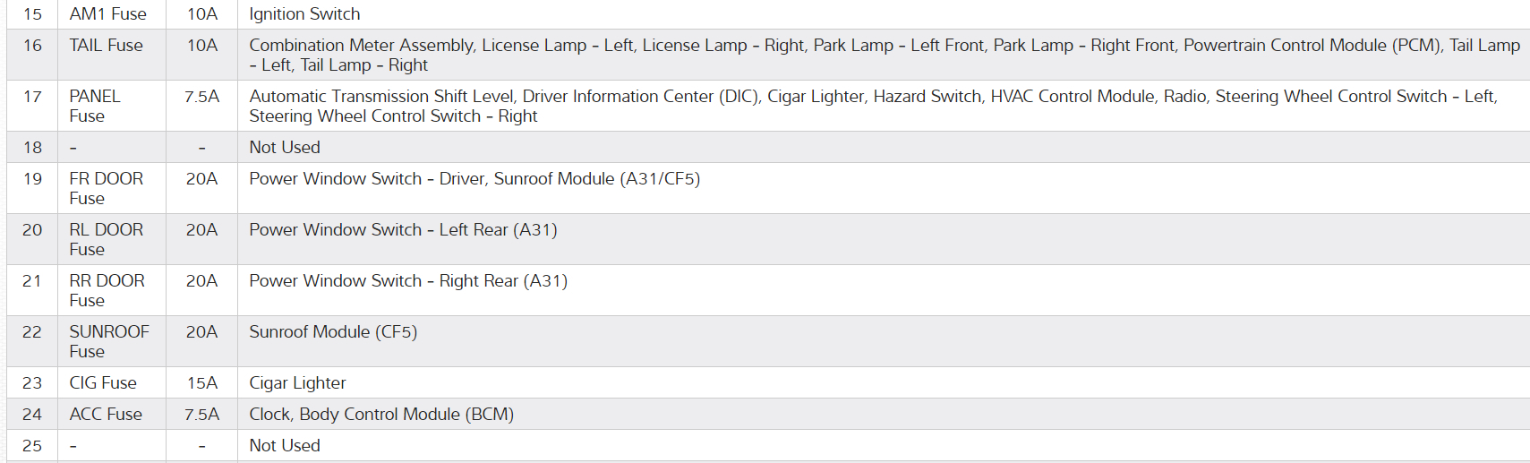

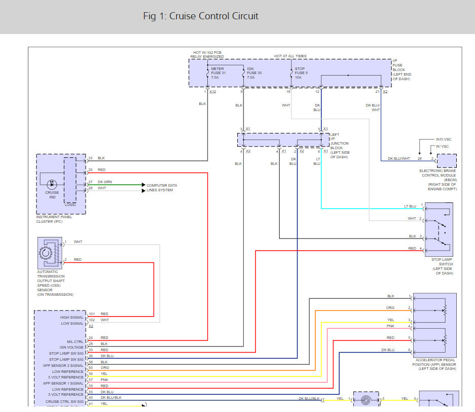

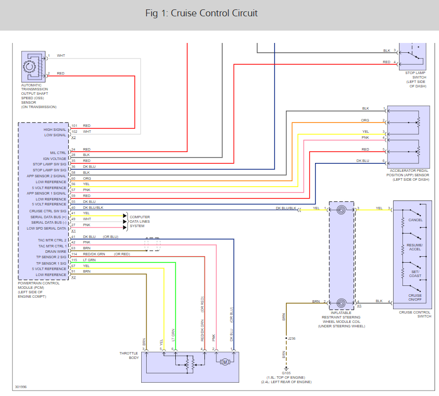

My cruise control does not turn on and I do not know why. I go to auto repair he checked codes, do not have problem. And later he told with me my car does not have throttle body. I do not think so. Can you have me please!
