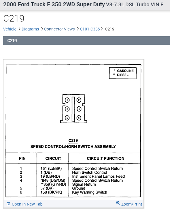

My husband changed out the entire steering column in my truck. The old one worked with cruise control and all. Since he put the new one in the cruise control doesn't work at all. It doesn't even light up on the dash when you push the on button. Already checked the wires everything is hooked up right, just the way it was with the old steering column. Not sure why it's not working.
