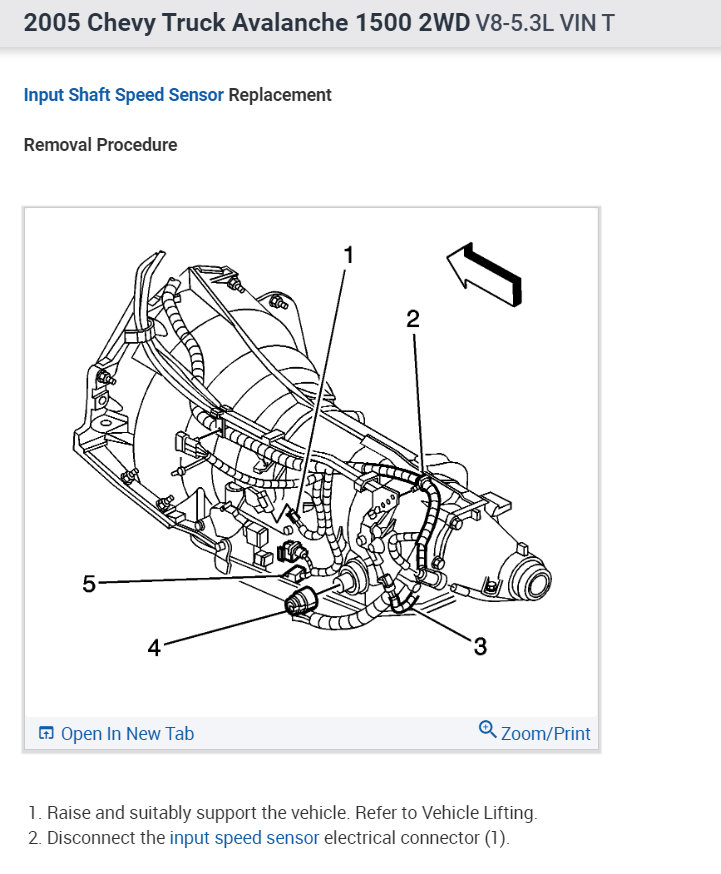

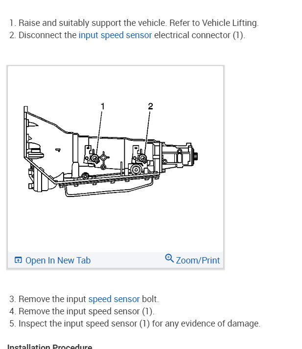

I have seen the input shaft speed sensor cause this issue as well. Here is the location so you can check it out.
