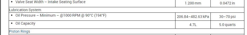

Below you will find the spec on the PSI which is pretty general but says between 30-70 PSI. So I suspect you will be on the higher end of this with the engine just at idle but at operating temperature.

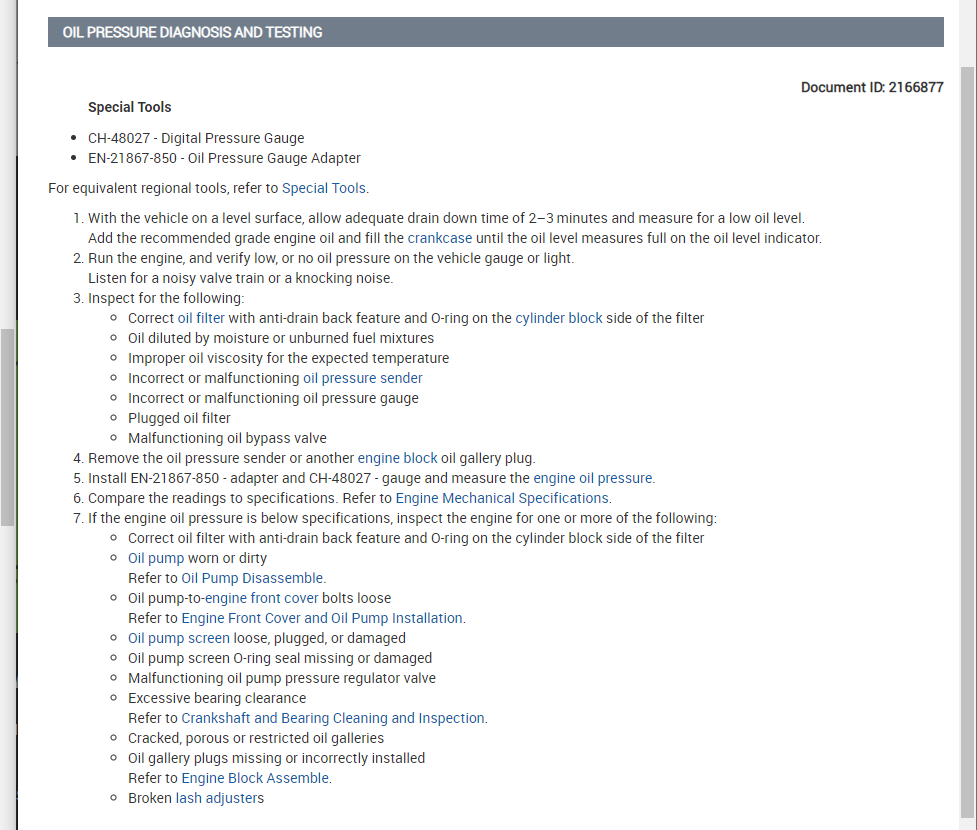

I attached the spec and process from the manual on how to check the oil but do you think you can get a picture of the oil from the dipstick and attach it here?
