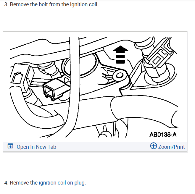

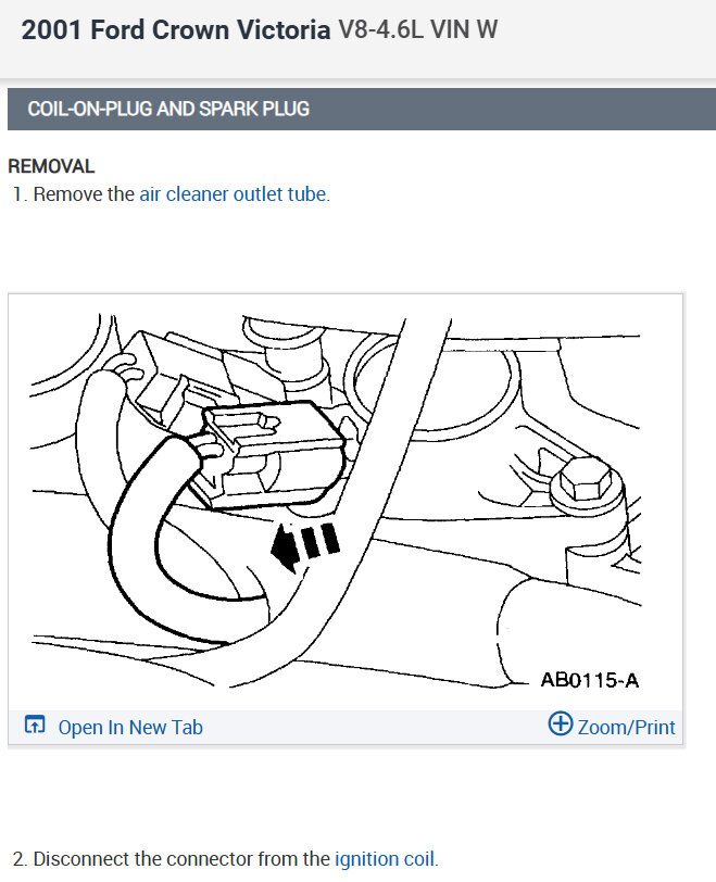

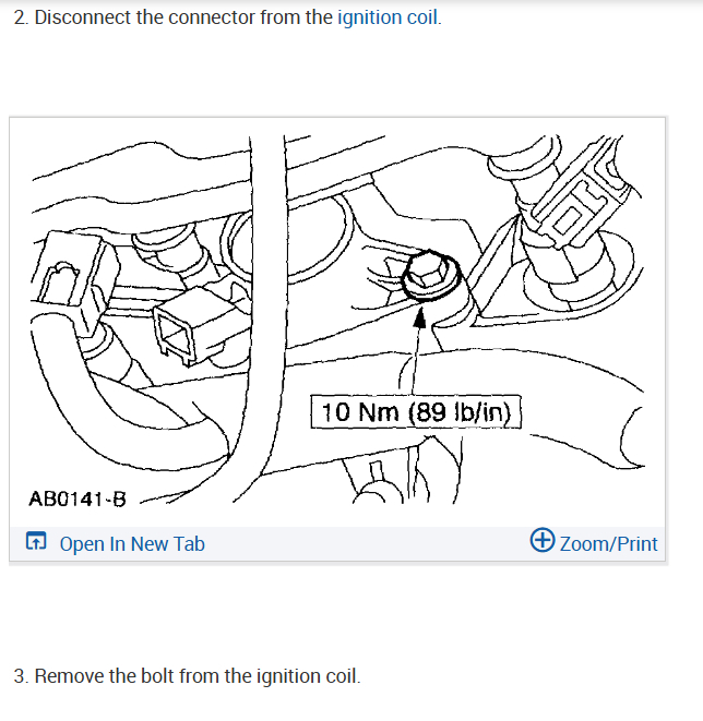

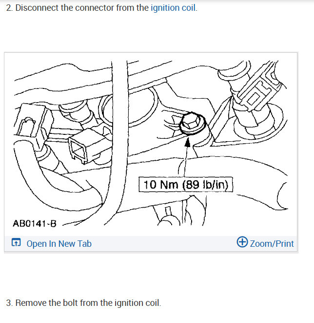

It sounds like you have two problems, I would check the wiring at the coolant sensor, I don't think a bad coil can cause the temperature to act up. I would replace #8 spark plug and ignition coil because they are known to fail on these cars, here is how in the images below and I have included a guide to help as well.
https://www.2carpros.com/articles/engine-misfires-or-runs-rough
Check out the images (below). Let us know what you find.
