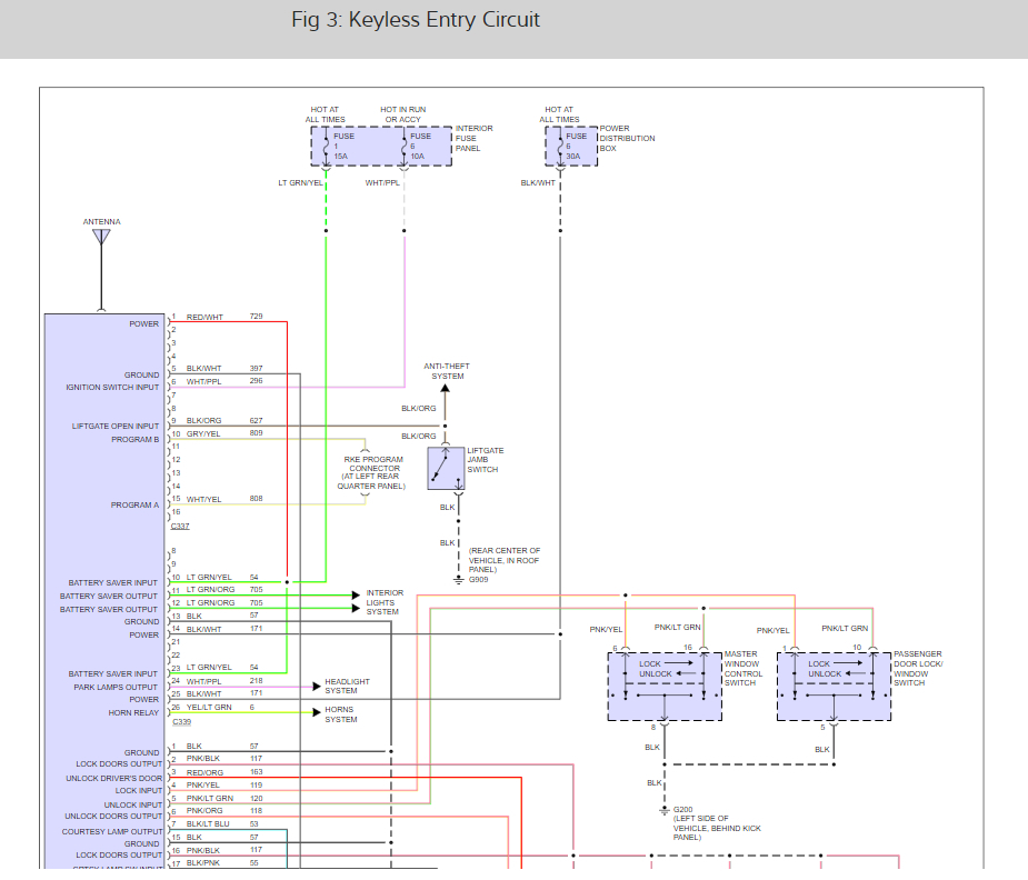

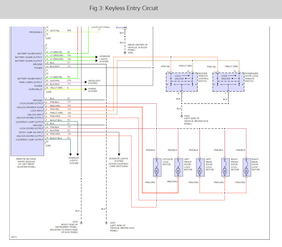

Both lock-Unlock works headlights while off.
Remotes do not work.
Door unlocks don't work.
Door locks work.
Drivers Seat adjust doesn't work.
Pass. Seat adj. Works.
Radio doesn't work.

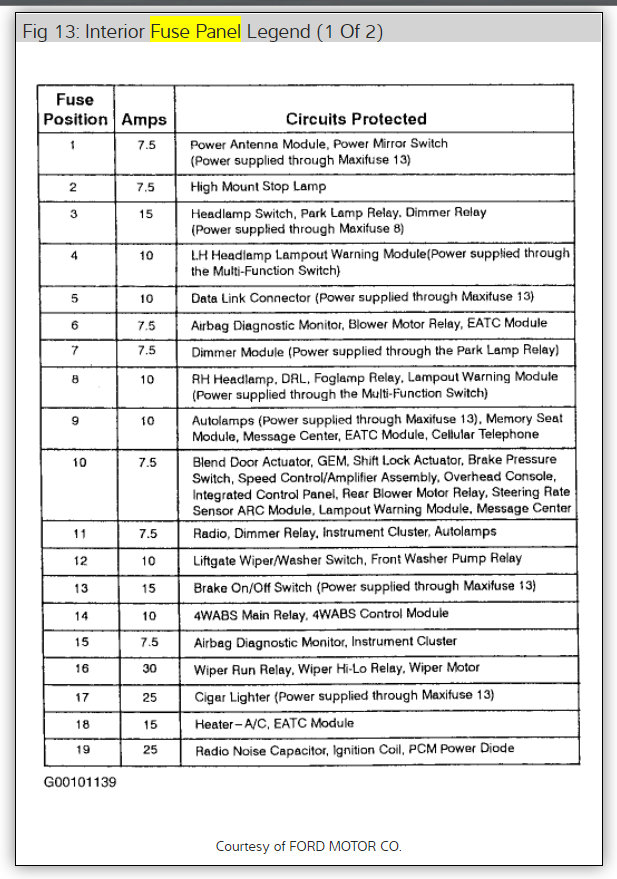

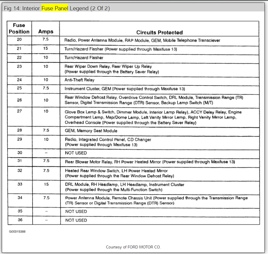

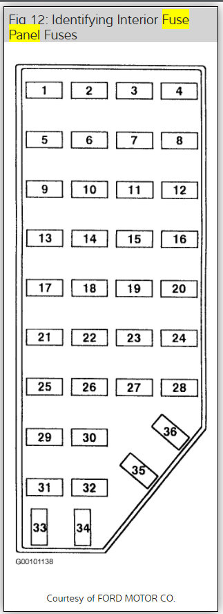

Checked fuses under hood - okay.
Didn't check fuses under dash.
Rear hatch doesn't unlock with key or button.
Everything else works.
