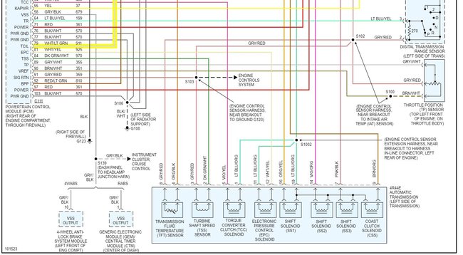

Is there a pair of wires on the multi-pin connector going to the transfer case that carry a speed signal of some sort? I can parallel feed to the two-pin connector to let it see some kind of shaft speed.
Mar 12, 2022 at 9:45 PM
Good morning,
Can you tell me the color wires for the 2-wire connector?

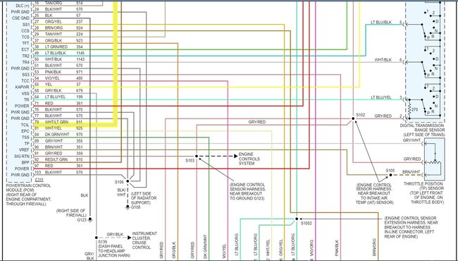

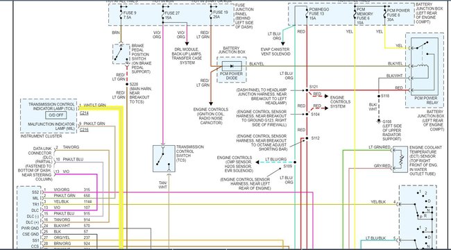

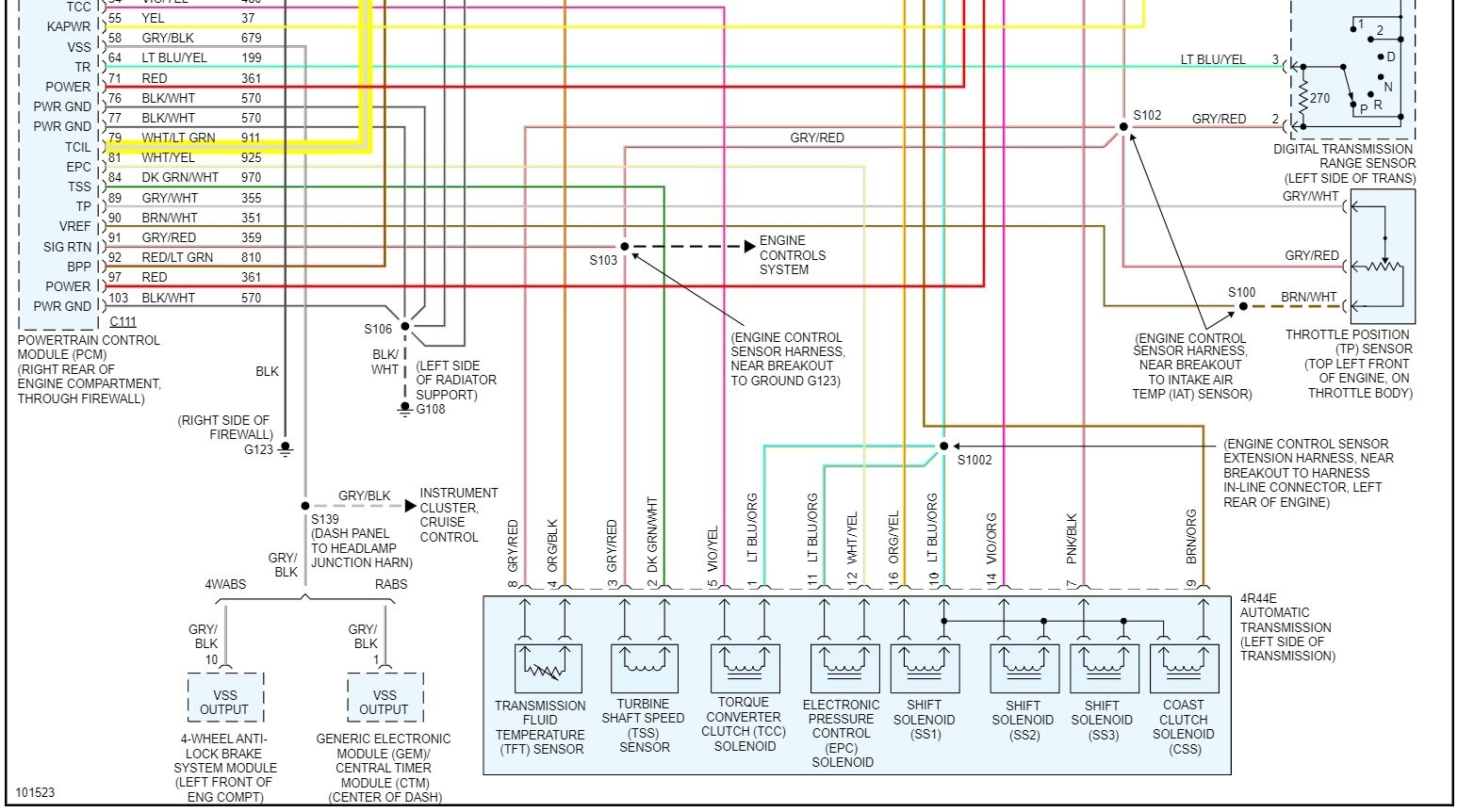

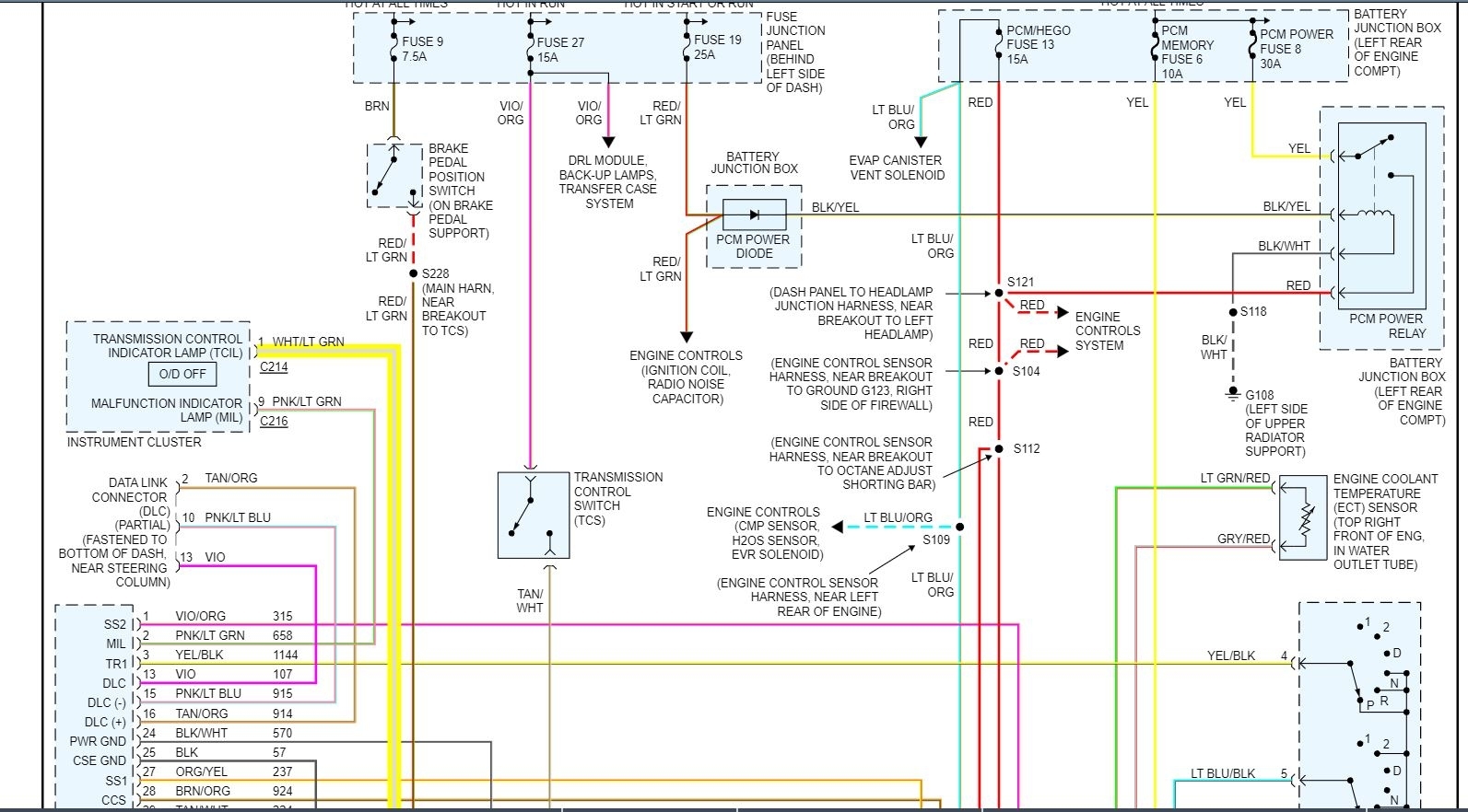

I attached the wiring diagram for you for the 1999. 2000 is identical.
The only difference is the PCM. If you give me the colors, I will trace them out.
The simple answer to the other feed is no. If that were the case, the factory would have used it that way.
