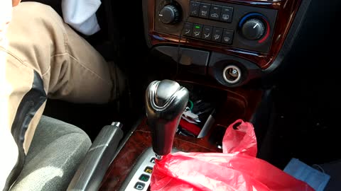

Here is a video. The noise can be heard especially well when I switch gears. It's a little hard to hear otherwise because the engine on this car is loud. I think there is an exhaust leak somewhere.
Mar 6, 2021 at 1:02 PM
I watched the video, but there was no audio. I'm not sure why.

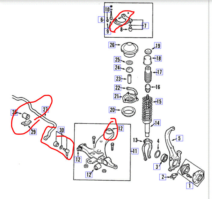

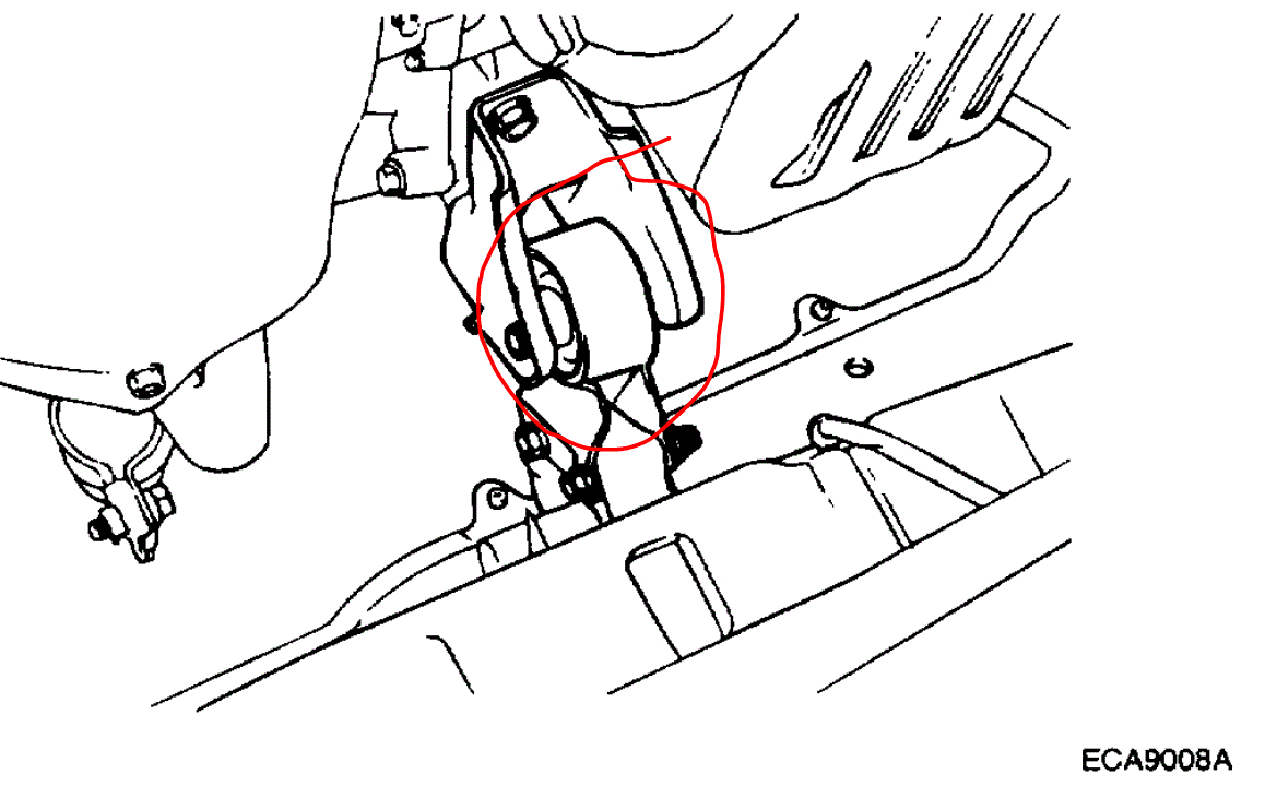

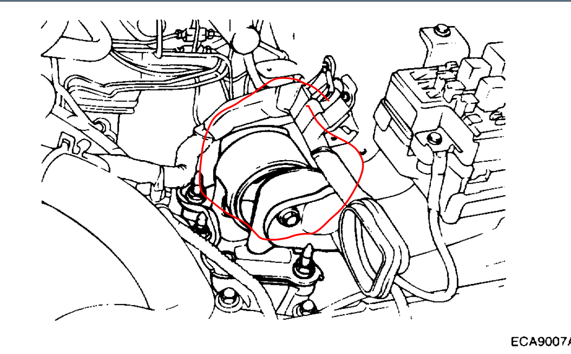

Have you checked the engine mounts as mentioned above? Also, I have also seen sway bar bushing make a noise like this as well as control arm bushings.
I attached a pic of the front suspension below. I circled the components if concern. Take a look at them and make sure nothing is loose or dry rotted.
Also, when the vehicle is parked, bounce the front to see if you can recreate the sound. Additionally, while it's in park, rock it back and forth to see if you can make the sound.

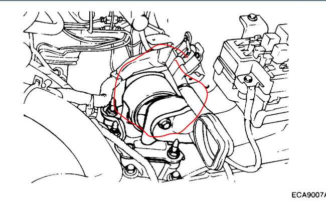

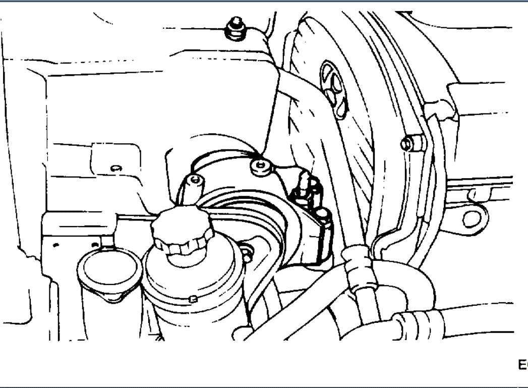

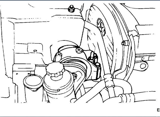

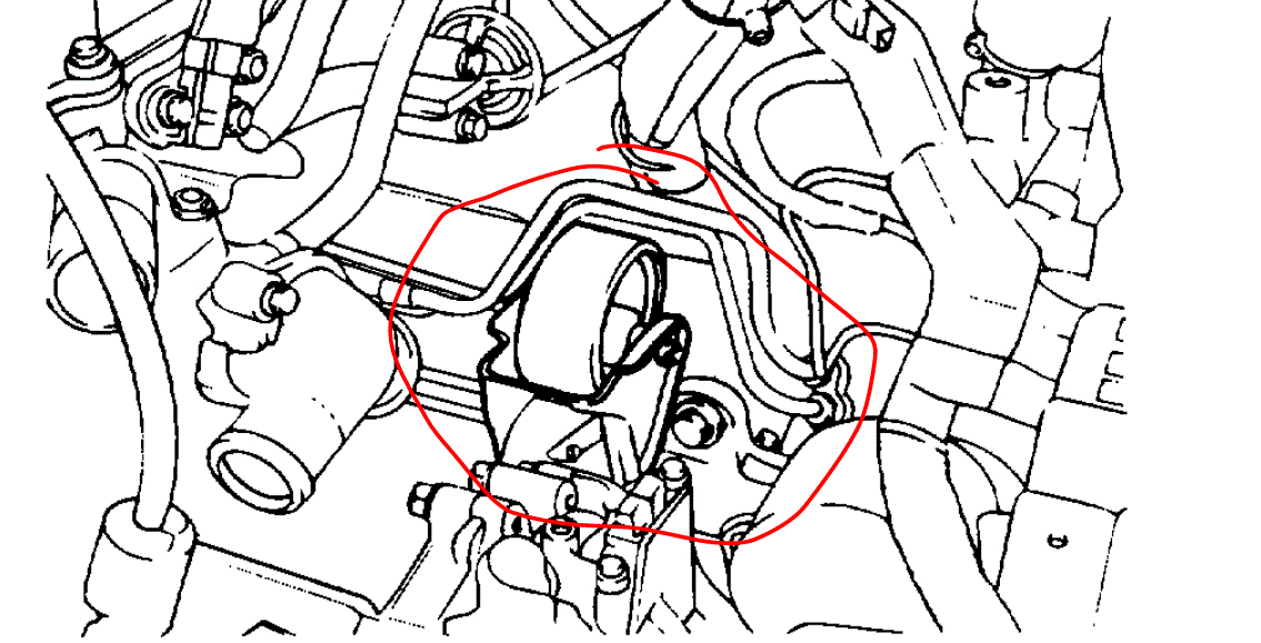

By the way, pics 2, 3, 4, 5 show the engine mounts/roll stoppers. Check them as well.
Let us know what you find.

I accidentally uploaded the wrong clip. I uploaded the correct clip to YouTube to avoid audio issues. Here is the link:
https://youtu.be/bBeUXvIjYjw
I will check the engine mounts and bushings as soon as possible. I will note though that the car doesn't shake much at all. It's actually pretty smooth. Same goes for steering. I heard that bad engine mounts can cause the car to shake a lot.

Thanks for the images you provided. They were very helpful. The engine mounts look normal. There is some rust but they don't seem loose or structurally compromised. The bushings in the suspension seem dry rotted and flattened in some areas. The outer tie rod bushings don't look good especially. I noticed today that the creaking stopped, but I believe this is because of an increase in temperature. It was about 60 degrees Fahrenheit today and lately it has been cold in my area and I heard that bushings creak more in colder temperatures.
Mar 10, 2021 at 5:34 PM
Absolutely. Temperature certainly can cause them to make more noise. Try this. When it starts making noise again, spray one bushing at a time with something like WD40 and see if the sound changes or goes away. If you spray all of them at once, you won't know which one made the difference.
