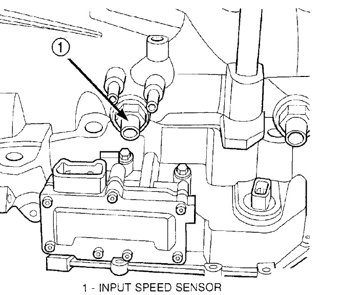

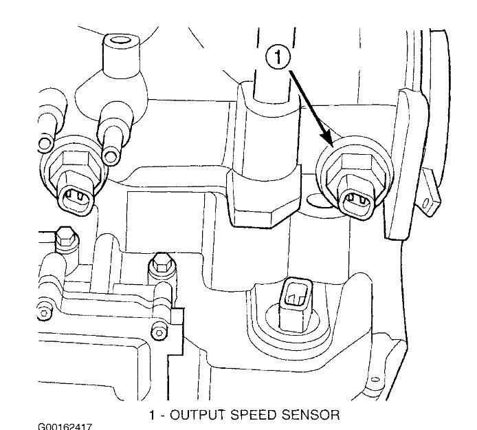

Ok it came back my input and output speed sensors of my transmission. Where are those located on my 2003 Dodge Neon?
Jun 5, 2013 at 2:31 PM
HMAC300
  • 48,601 POSTS
input speed sensor is on the lower left of engine compartment and the output speed sensor is on the transaxle. see pics it may be awiring issue as well but if it doesn't cure your problem then have atrans guy look at it.
