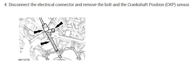

Crankshaft sensor location needed.

The crankshaft position sensor is at the left rear of the engine. Here is the location of the sensor, check out the images (below). Let us know if you need anything else.
Image (Click to enlarge)
