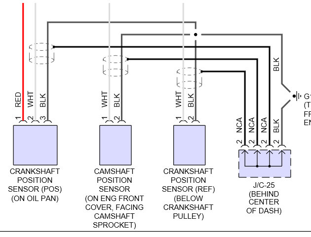

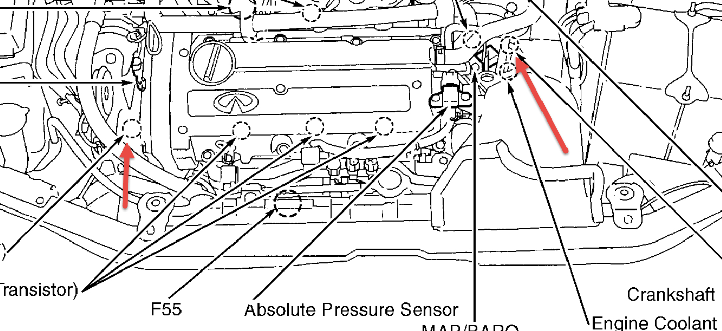

Where is the crankshaft position harness on this car?
Jul 9, 2017 at 11:40 AM
HMAC300
  • 48,601 POSTS
There are two, one is for reference and other is for position. you need to know what code you are getting if any the harness will lead to each one has three wires the other two. See pictures.
