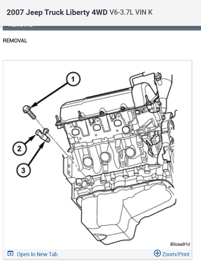

I tried replacing the crankshaft sensor I got from AutoZone. The sensor would not fit, figured it was wrong part, so I ordered from a different store. Same thing happened, the old one goes right back in. I am on my fourth sensor, but they do not fit. I compared old and new and they look identical. Any ideas what is wrong? Thanks
Mar 7, 2025 at 5:58 AM
Can you upload an image of the old and new crankshaft sensors so I can see? To be clear this is the sensor you are replacing, correct? Check out the images (below).
