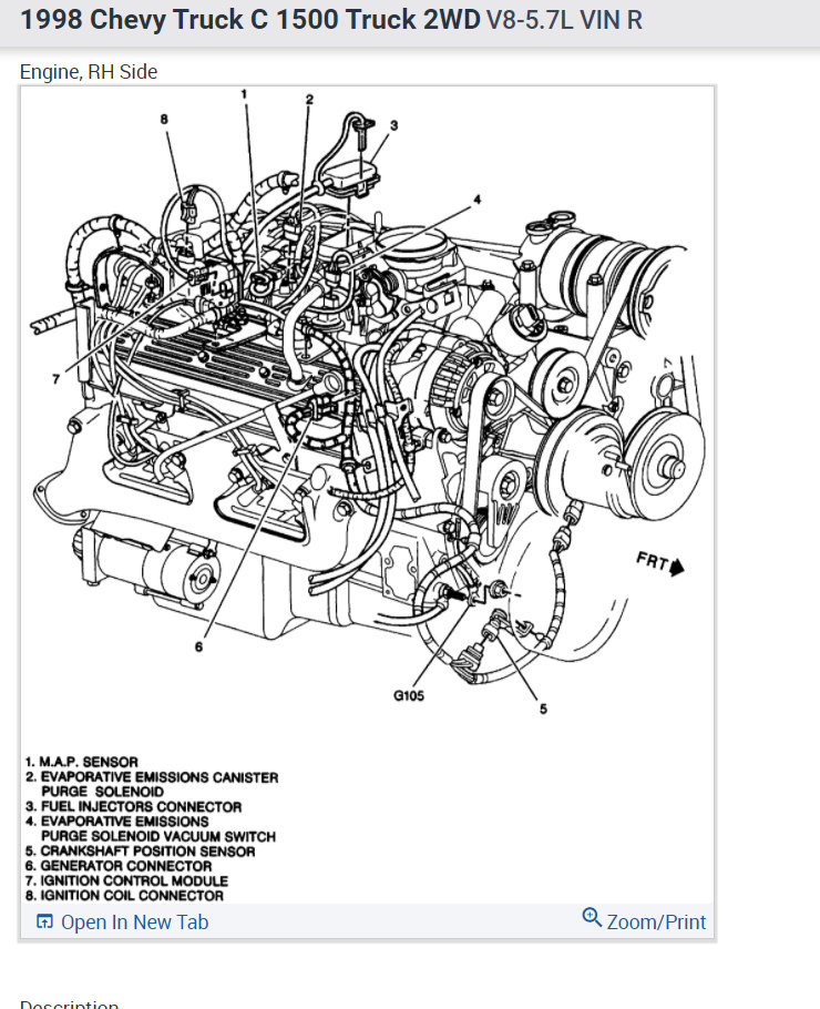

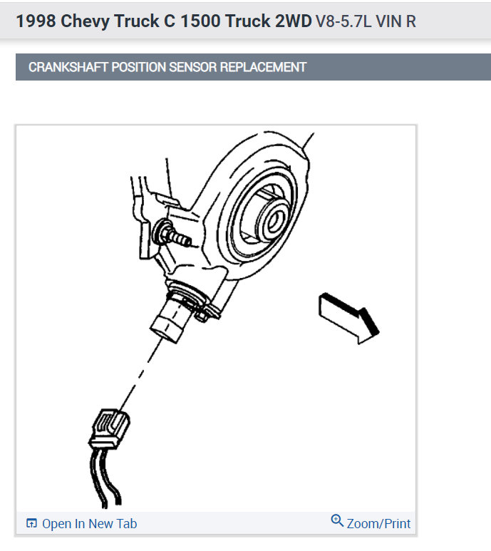

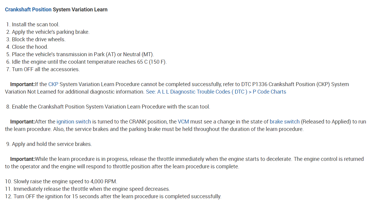

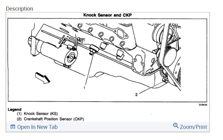

I need to replace the crankshaft angle sensor can you help me please?
Feb 11, 2016 at 12:30 PM
JOHNNYT73
  • 924 POSTS

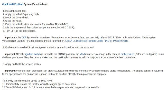

This video will show you how to replace the sensor with diagrams below to show you how on your car.
https://youtu.be/sKo7xRWVNqY
Here is how to replace the sensor with the sensor relearn procedures as well. Check out the diagrams (Below). Please let us know if you need anything else to get the problem fixed.
Feb 11, 2016 at 12:37 PM
ROBERT85387
thanks you worked perfect I cant believe this site if free :)

c3500 2wd . I have been looking here and other sites for the location on this engine with no good results. I have looked at the engine and it is not on the front lower (passenger side 7 pm) location, or the drivers side at the harmonic balancer.
Jan 18, 2021 at 10:20 AM (Merged)

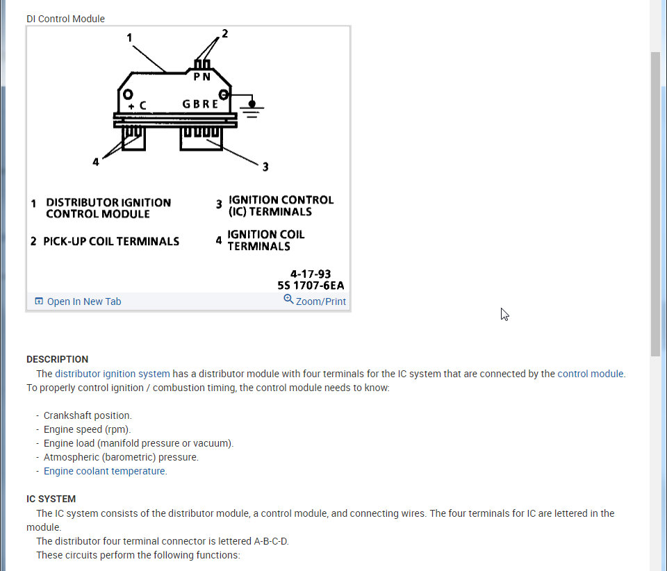

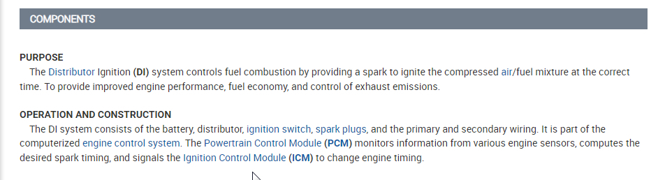

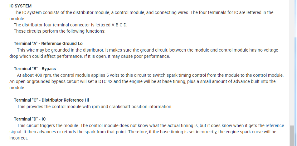

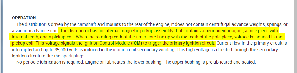

Danny is correct but just to elaborate a little bit on it. This engine due to it having a distributor uses a pick up coil in the distributor that picks up the rotation of the crank shaft. It sends pulses to the ignition control module and it uses this to determine engine timing.
I am attaching all the info below for your review. Let us know if you have other questions. Thanks

So, I replaced my crankshaft position sensor, but a 2-wire plug came out of its plug on drives side of engine and i cannot find it location to plug it back in its a 1998 Chevrolet K1500 Silverado 5.0L.
Dec 10, 2024 at 2:02 AM
I am not sure what you are saying, can you clarify please?
