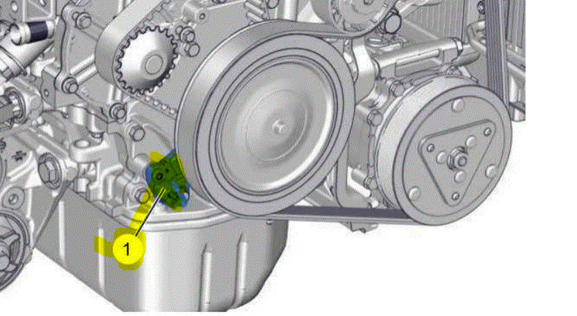

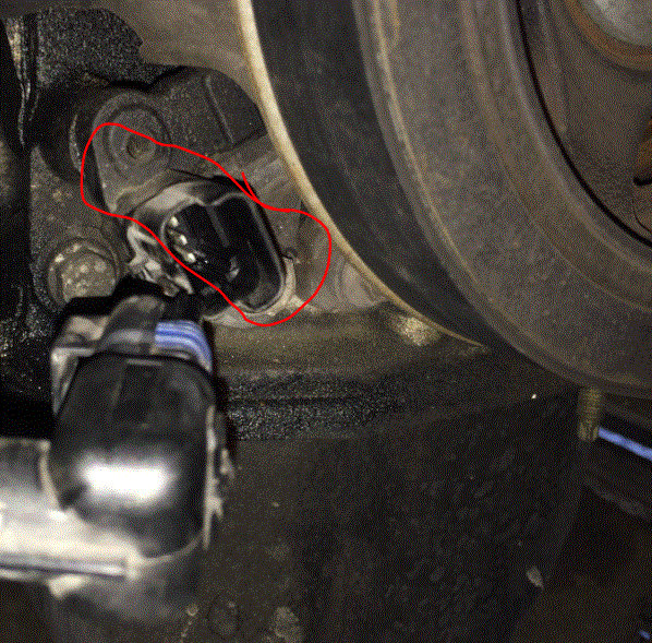

I can't locate the crankshaft sensor. I'm thinking it'll be behind the starter motor. Is that correct? If so, will I have to take the starter motor off to replace the sensor or is there another way?
Mar 19, 2022 at 7:06 AM
This vehicle isn't offered in the US, but I will do my best to help.
I did a little research and found the crankshaft position sensor is located near the crankshaft pulley at the front of the engine. I attached two pics below showing it.
According to the info I found, this is relevant for 2007 - 2011 model year vehicles.
As far as replacement, that looks like it shouldn't be hard. Here is a link that explains in general how to replace one. Hopefully, it will help:
Let me know if that helps or if you have other questions.
See pics below.
