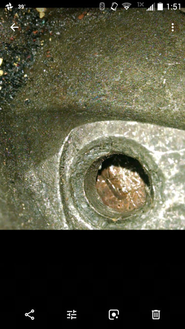

Here's a picture of the sensor hole.
Jan 5, 2019 at 6:45 PM
Good morning,
Wow, that hole is not in good shape.

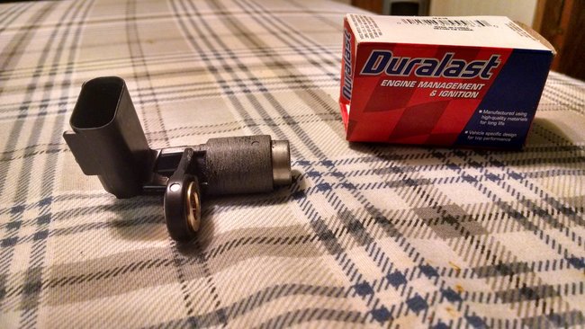

does the sensor fit in the hole?
what brand sensor did you buy and can you upload a picture of it?

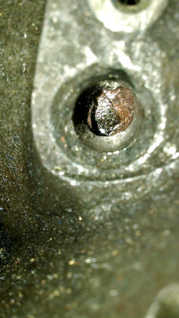

I have been working on the hole. How does it look?
Jan 6, 2019 at 10:55 AM
does the sensor fit in there tight?
Looks better.
Jan 6, 2019 at 11:01 AM
TWIZDID77
  • 18 POSTS
It doesn't fit yet. Does the entire dark circle come out? Still just the metal part of the sensor goes in.
Jan 6, 2019 at 11:07 AM
That last thin collar has to come out around the center. use a small chisel and try collapsing it in on itself.
Jan 6, 2019 at 11:12 AM

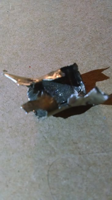

So I got this out of the crankshaft sensor hole. Which I'm assuming is the outer part of the magnet. I'm wondering where the rest of it is? Would it be pushed to the back of the hole or did it fall in oil pan?
Jan 7, 2019 at 5:34 PM
It most likely fell into the pan. drain the oil and see if any of the remnants come out.
Jan 7, 2019 at 5:41 PM

How much more is in there?
Jan 7, 2019 at 5:51 PM
look at the new one. compare it to what you have versus what is new.
the only part you got off before getting it out was the top. the rest is inside the pan

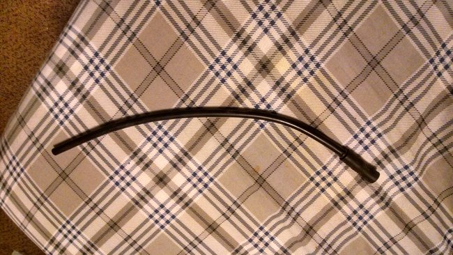

This was on the ground under the car.
Jan 8, 2019 at 12:18 PM
Looks like a vacuum line from somewhere. this will not cause the no start.
