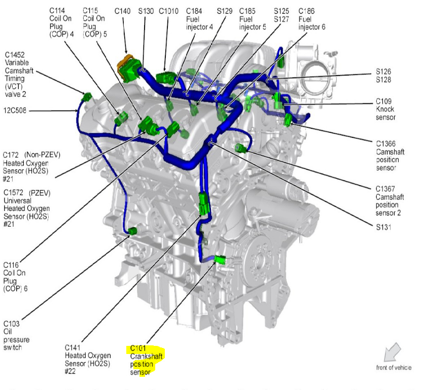

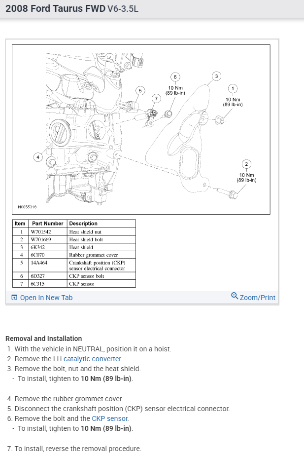

I need help locating a crankshaft sensor.
Jun 1, 2022 at 5:56 PM
SQM
  • 6,383 POSTS

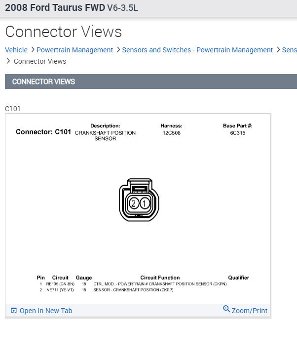

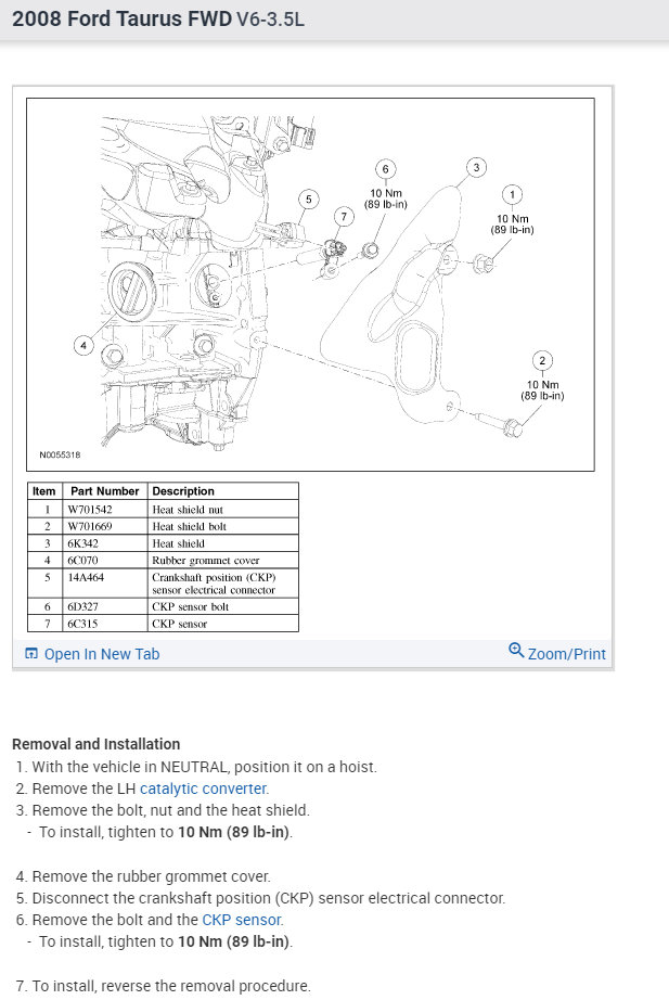

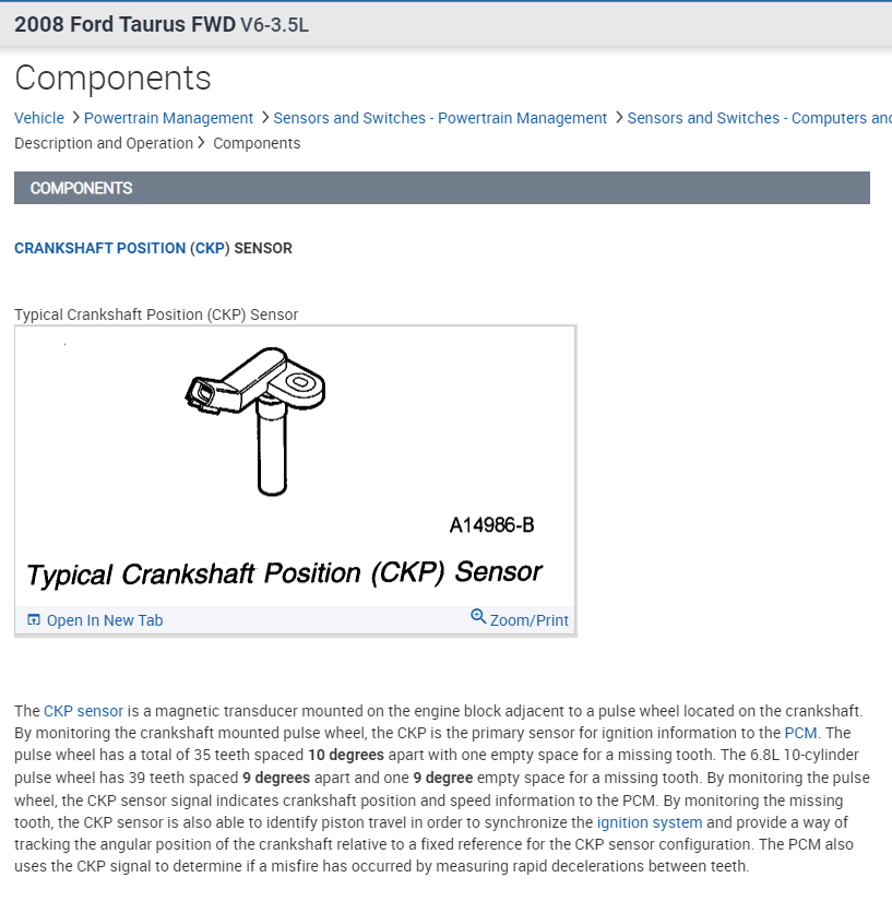

The crankshaft position sensor is located on the lower left-hand side of the engine.

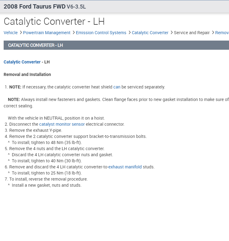

In order to replace the sensor, you will first have to remove the left-hand side catalytic converter.
I have attached diagrams below for your reference.
Let me know of any questions.
