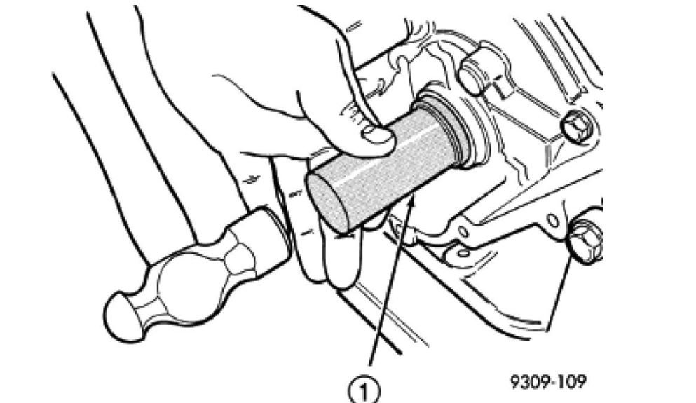

I have a oil leak at front of engine.
I cannot pinpoint it but i see a oil mist because by spinning of drive belt and pulleys. I see mist mostly from idler pulley area.
Whole front area of engine is wet from oil. Crankshaft Seal failure?

Good morning,
Yes, it is possible.
I would start by going to a self serve car wash and clean the front of the motor. then run the motor and see if you can pin point the exact are that is leaking.
https://www.2carpros.com/articles/symptoms-of-a-front-crankshaft-seal-leak

Hey Roy,
I have already cleaned engine with degreaser and Brake Cleaner multiple times.
Cannot pinpoint leak source.
I am going to replace Crankshaft seal.
Thanks!

You can always add some oil dye to the oil. It will turn yellow at the source of the leak for you to view.
