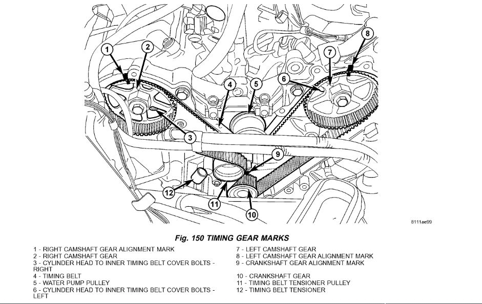

I bought this vehicle with a broken timing belt. the car would crank over but would not start. I was in the process of replacing timing belt and setting it up to top dead center, but realized the crank is not turning all the way by hand. it reached a spot and stops clockwise.but will turn in reverse and the stops.i read the engine on this vehicle is a non interference engine.what else would cause this problem besides a bent valve?
