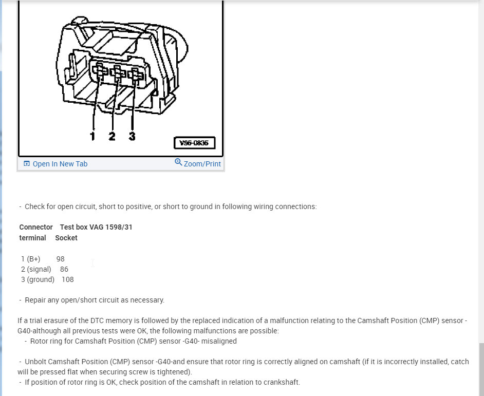

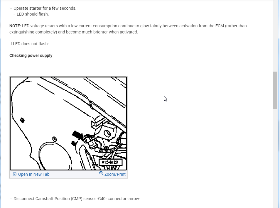

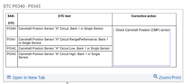

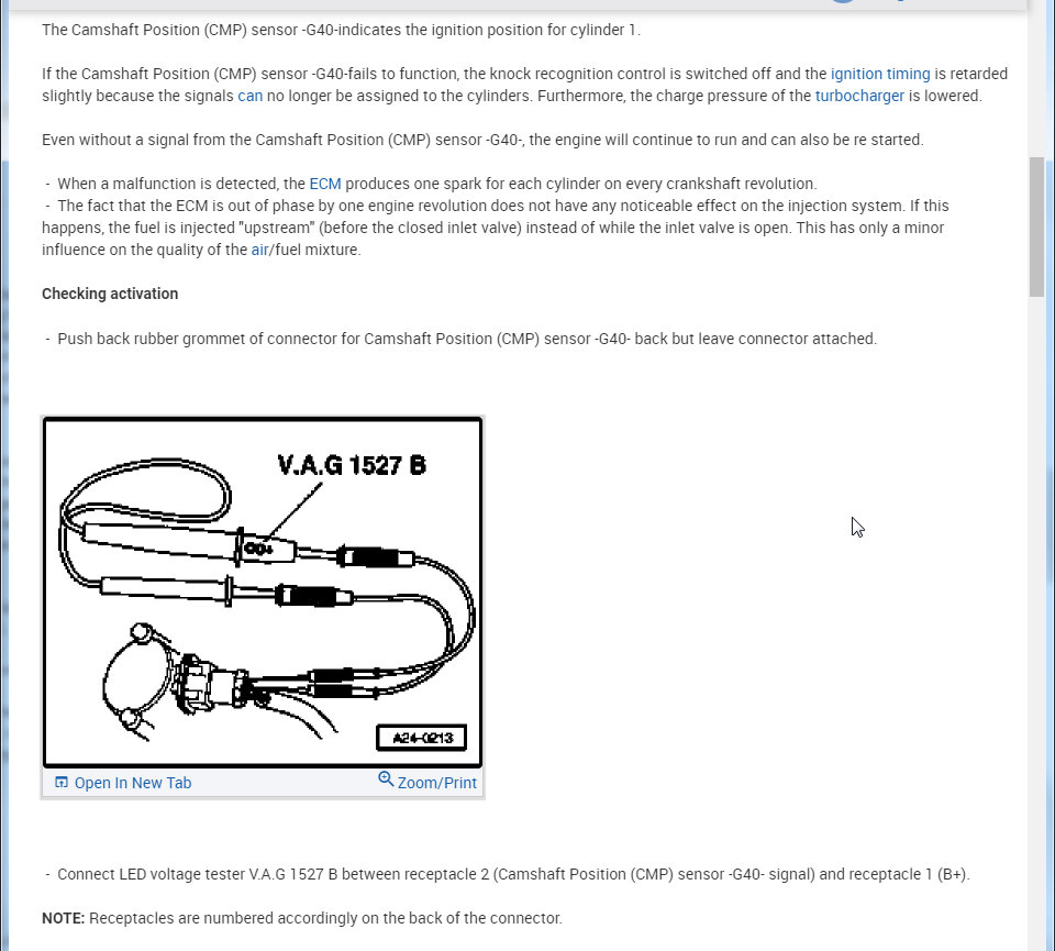

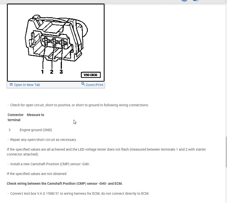

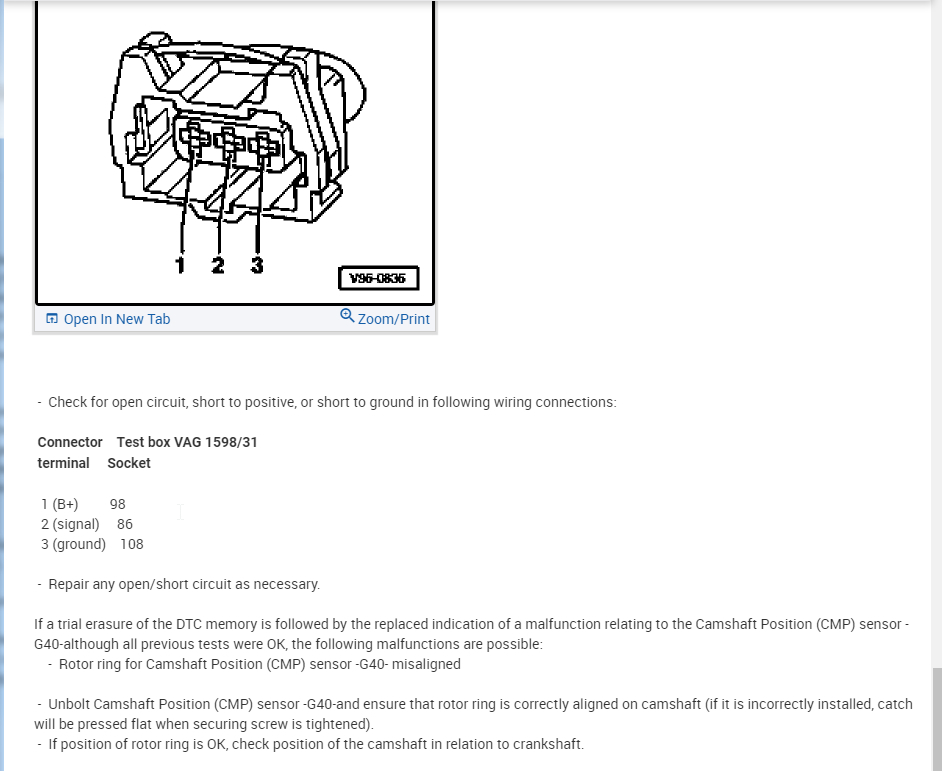

The P0340 code is for the Cam sensor not the crank sensor. I attached the diagram that we need to perform in order to find the issue with this code. It could be the sensor or the wiring so we need to perform each step and see where it leads.

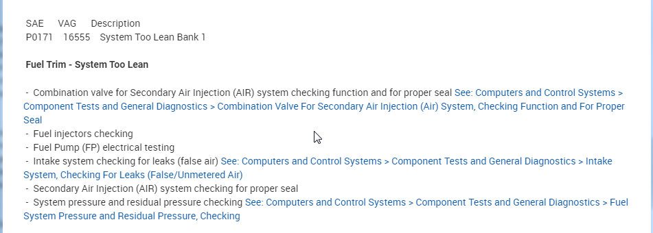

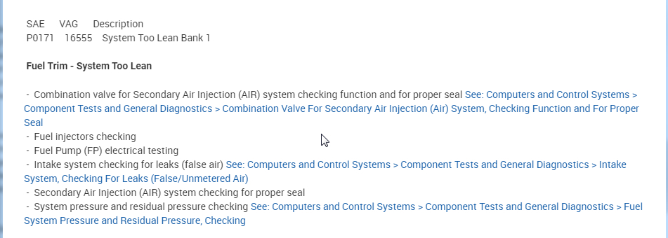

The P0171 is saying that the system is running lean. This is most likely as a result of the cam sensor code.
Run through this info and let me know what you find or if you have questions. Thanks

It is unlikely that the sensor is the issue if you replaced it and got the same code right back. I would run through the testing that I attached previously to find out where the issue is. More then likely you have a wiring issue.
Run through that and let me know what questions you have. Thanks

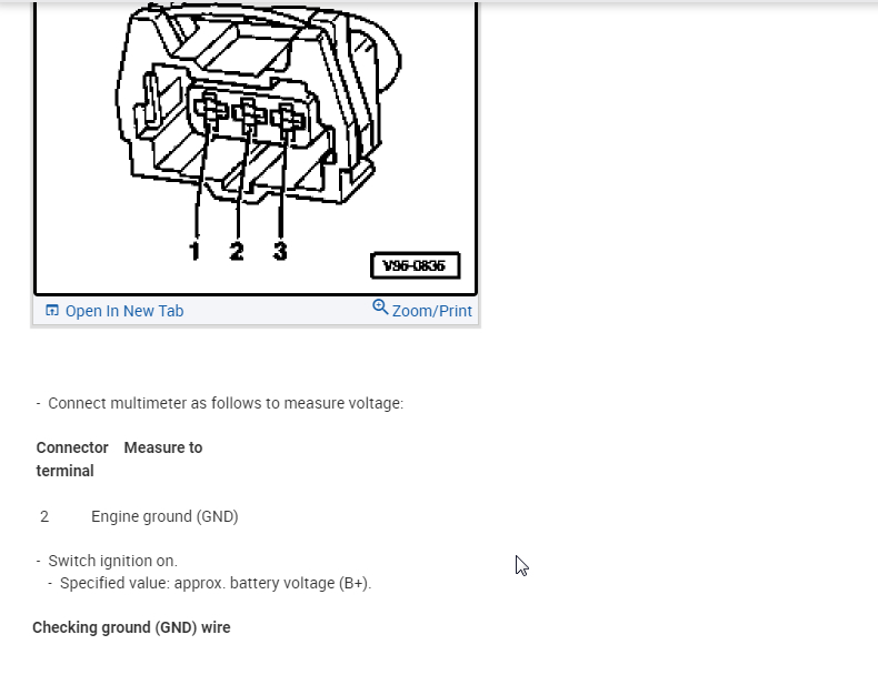

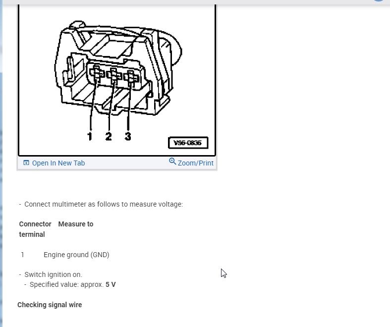

Hello, today I disconnected the plug that goes to the camshaft sensor and I did a check with the engine running and it gave me a voltage of 4.99 volts on pins 1 and 3, is this correct? I would greatly appreciate your guidance in getting to the problem. have a nice weekend.
Jun 6, 2020 at 10:44 AM
Are you still getting P0340? If so we need to just follow the testing that I attached for that code. If you unplugged the sensor and have almost 5 volts on these two wires then that is correct.
Basically those are your supply voltage and return voltage. The other wire is the signal wire that will vary its voltage depending on the signal from the cam sensor. This is the wire that the PCM knows the position of the cam shaft.
Again, let's start working through the testing step by step and tell me what you are having issues with and we can work through it. Unfortunately I cannot help determine the issue without this info so we need to run through it and see what comes back for each step.
