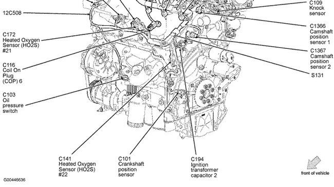

Need exact location of a crankshaft position sensor, please.
Dec 6, 2016 at 3:50 AM
HMAC300
CERTIFIED EXPERT
48,601 POSTS
see picture for location. if you scanned for codes it may not be the crank sensor, however may be a wiring issue or connector. Check out the diagrams (Below). Please let us know if you need anything else to get the problem fixed.
