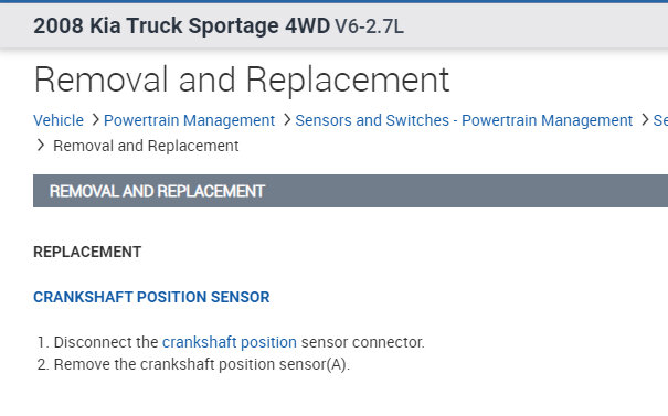

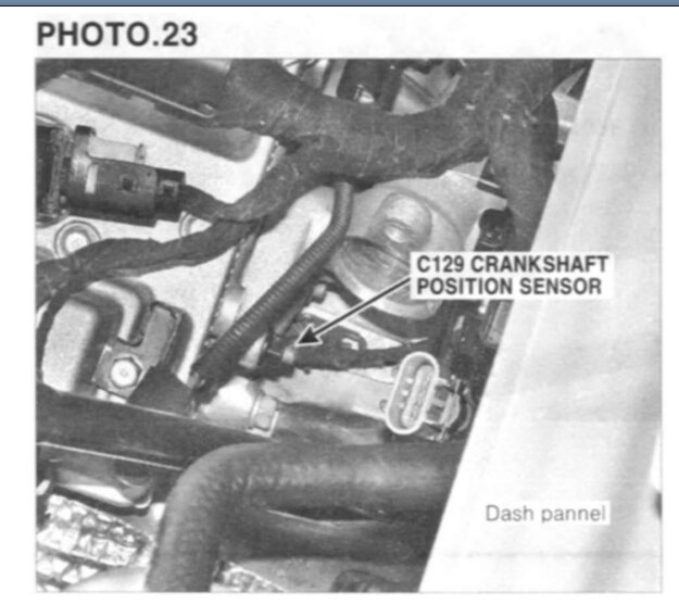

The fresh air intake needs to be removed. (See pic 1) Once that is off, the sensor is located under it. (See pic 2)

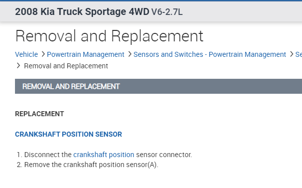

Pic 3 is very vague directions from the manual.

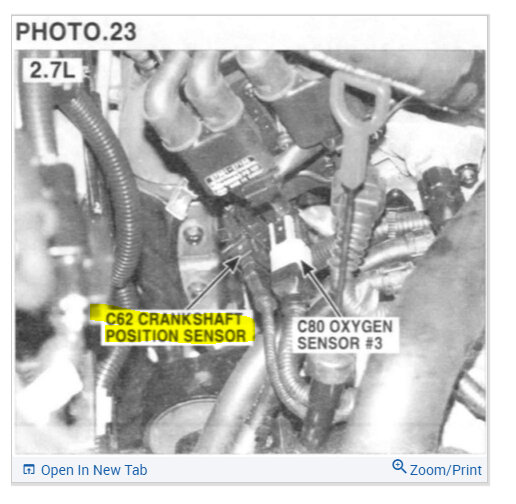

This engine is a 3.3 liter. That's our problem. We can't seem to get a diagram of the 3.3 liter. Although helpful and much appreciated this is not what our engine looks like. KIA Sorento LX 4x4 3.3 liter. Please help
Apr 19, 2023 at 6:38 PM

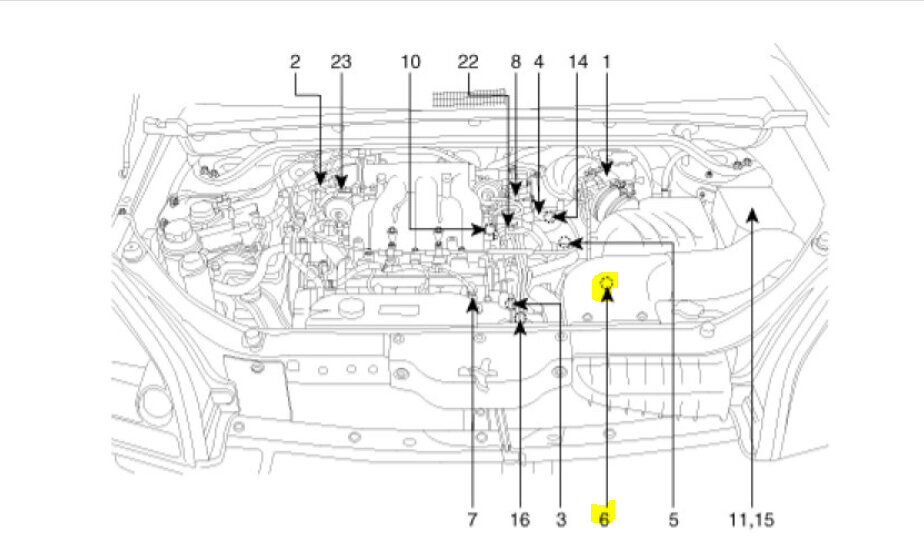

Take a look at this pic. I am so sorry that I sent the info for the 2.7L. Here is what I'm showing for the 3.3L.
Let me know if this helps.
joe
See pic below.
Apr 19, 2023 at 8:34 PM
LEE PERRY
Thank you so very much! I'm very grateful..
