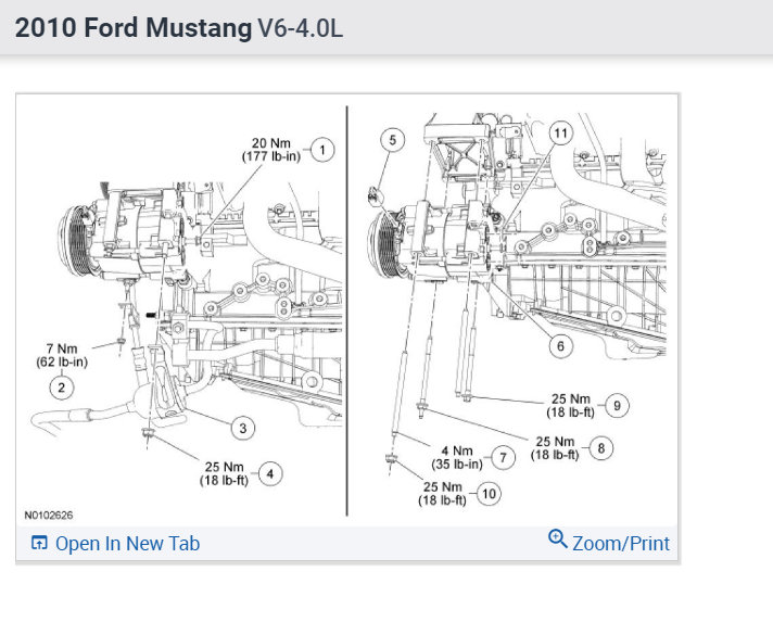

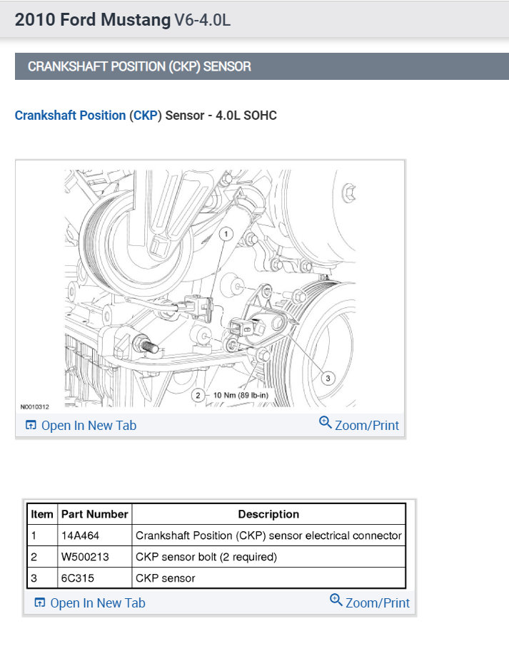

Do I have to drop the A/C motor to get to the crankshaft position sensor on this year Mustang? Haynes manual doesn't mention it, but forums do. Also do I access it from under the car?
