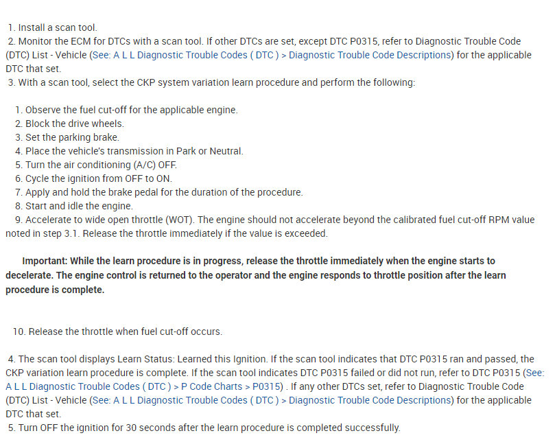

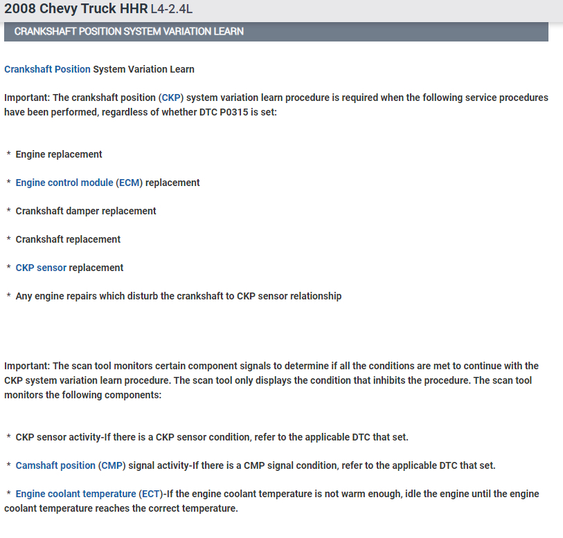

Unfortunately this will need the scan tool in order to complete the relearn.

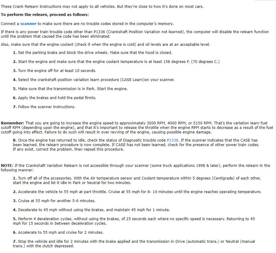

However I have attached a generic relearn that might work on your HHR. It is the third image.
