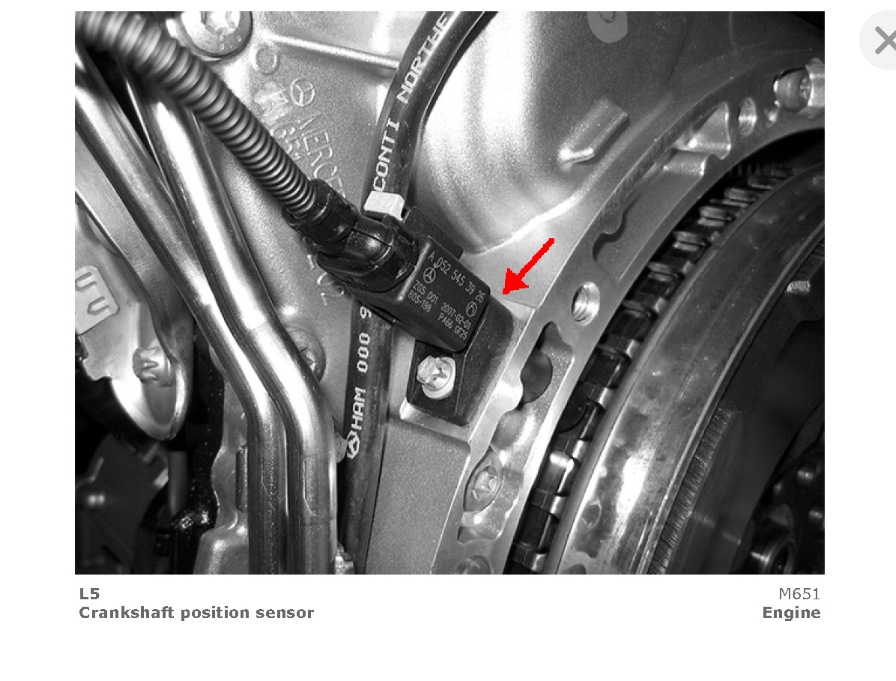

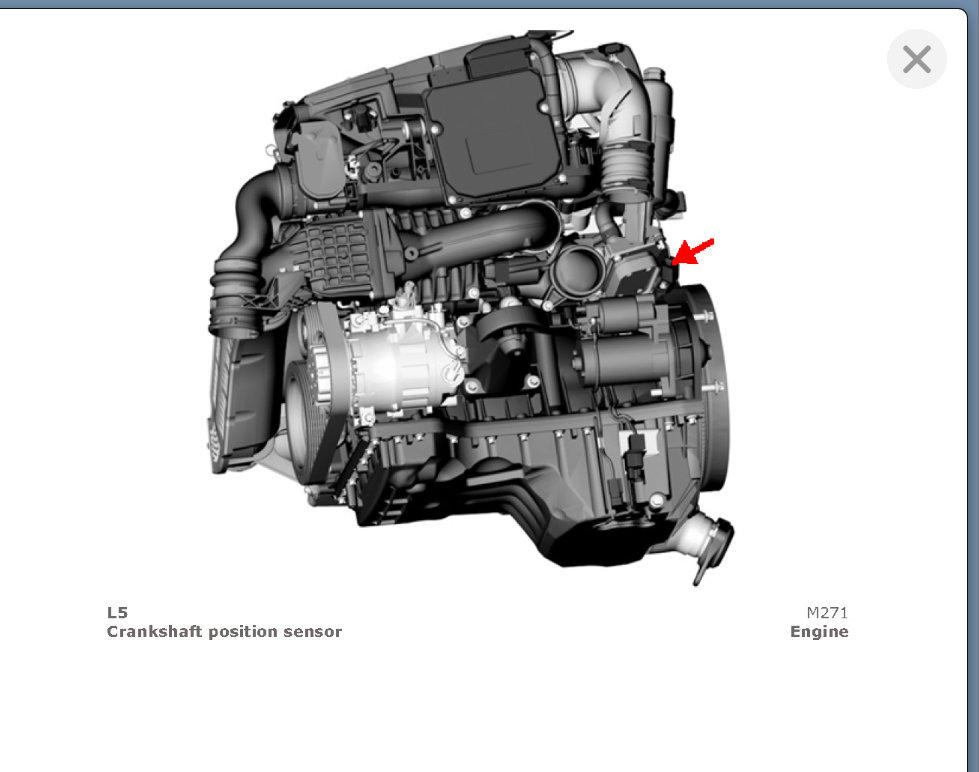

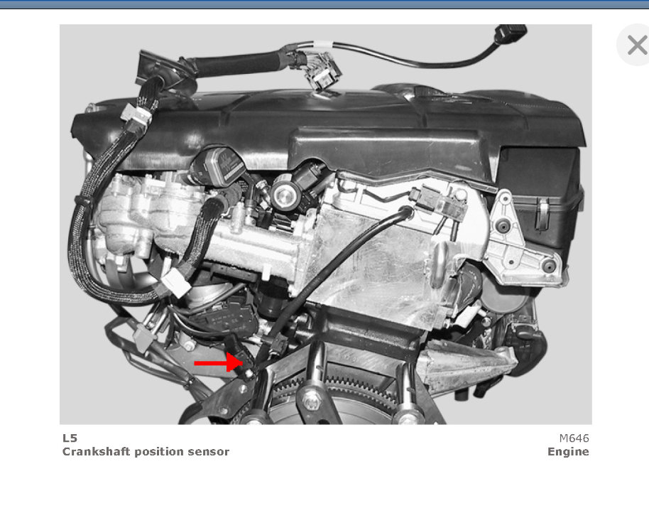

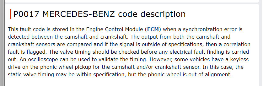

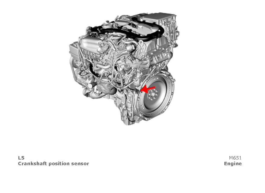

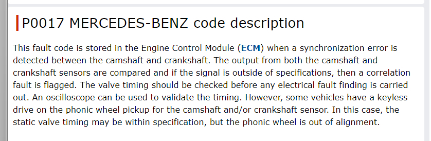

I got the code p0017 and p0138. now I try to solve the p0017 first for crankshaft position sensor but I do not know where is the sensor on my car. can you tell me please me? Thank you
