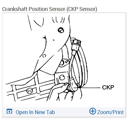

Yep, this can be the crankshaft sensor or the fuel pump etc. We need to see if it will start on starting fluid when the engine stalls out, this way we can see if the problem is ignition or fuel related. Please go over this video which can help us see what the problem could be:
https://www.youtube.com/watch?v=lXLJbuAZ4CE&t=29s
Here is the location of the crankshaft sensor which would be a good start because when they fail it will cause this issue, it is on the right side of the engine block near the front. Check out the images (below). Please upload pictures or videos in your response of any problems so we can see what to help you with.
