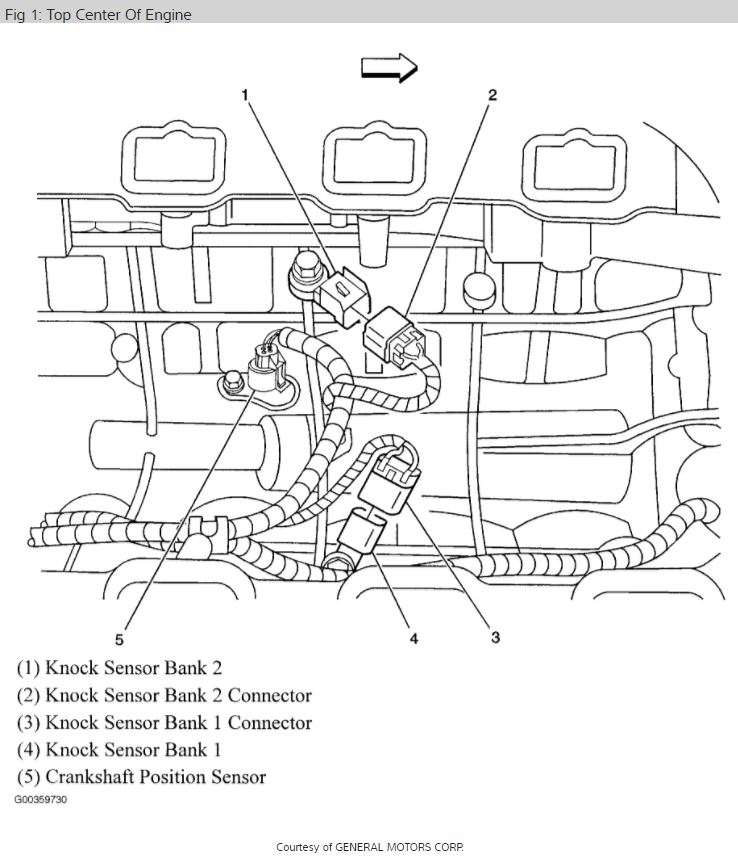

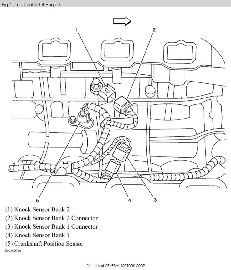

Hi, I just need to know the location of the crankshaft position sensor for the car listed above.
Apr 4, 2018 at 10:27 AM
PATENTED_REPAIR_PRO
  • 1,853 POSTS
Under the intake manifold. Check out the diagrams (Below). Please let us know if you need anything else to get the problem fixed.
