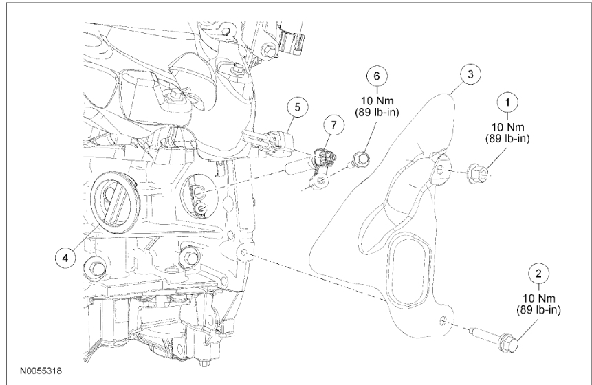

Where is the crankshaft position sensor located on a 2008 Ford Taurus
Apr 9, 2026 at 2:14 PM
Yep, they hide the crankshaft angle sensor on the left side of the block near the flex plate, (rear oft he block) behind a rubber cover. Check out the images (below). Let us know if you need anything else.
