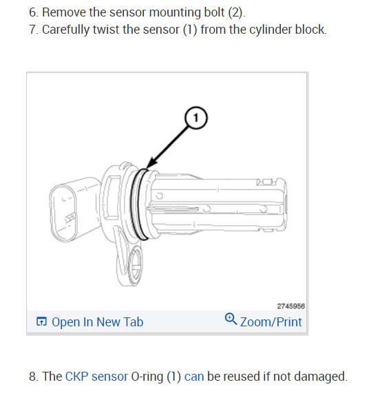

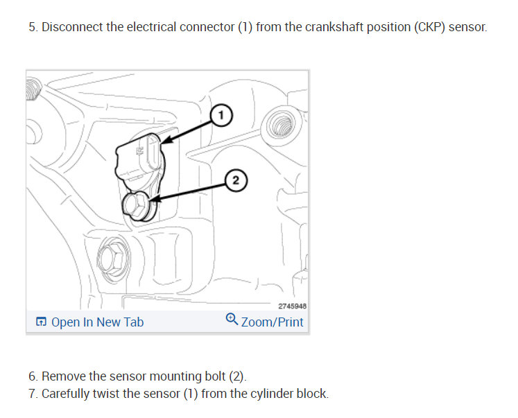

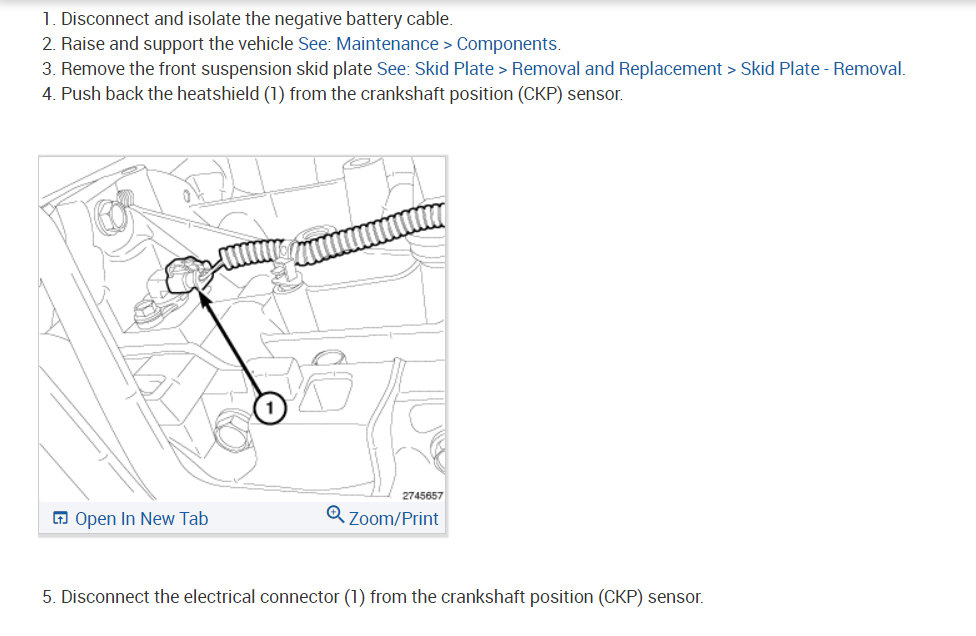

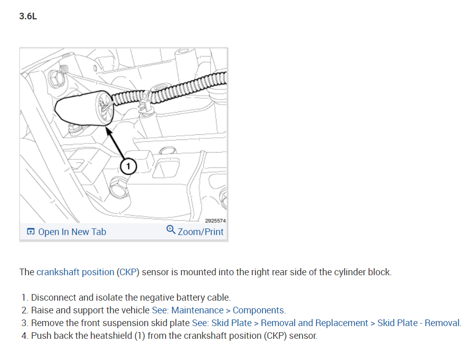

I am having a hard time even finding the thing to change it. I think I know where it is but how are you supposed to get to it without taking stuff off of the vehicle. Have any of you done this job before and have any pictures or a video to look at to see what I need to do?
