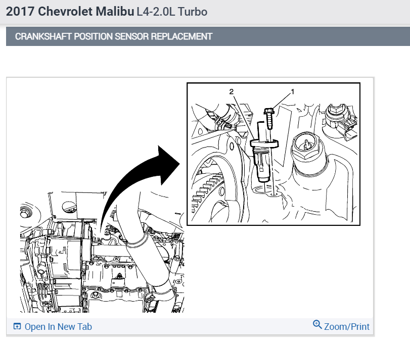

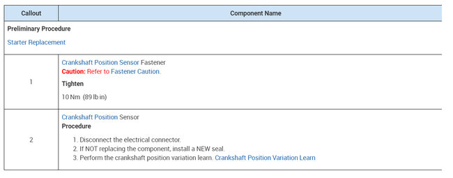

Trying to find the location of the crankshaft position sensor on my car listed above premier 2.0L turbo.
Aug 14, 2023 at 7:20 PM

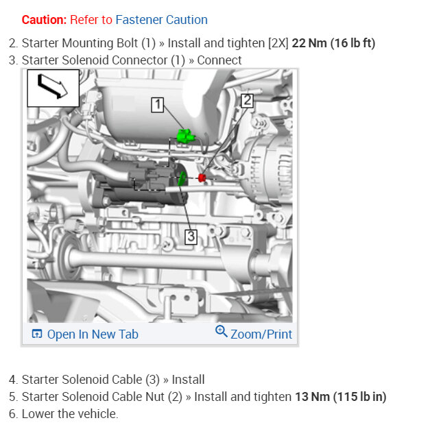

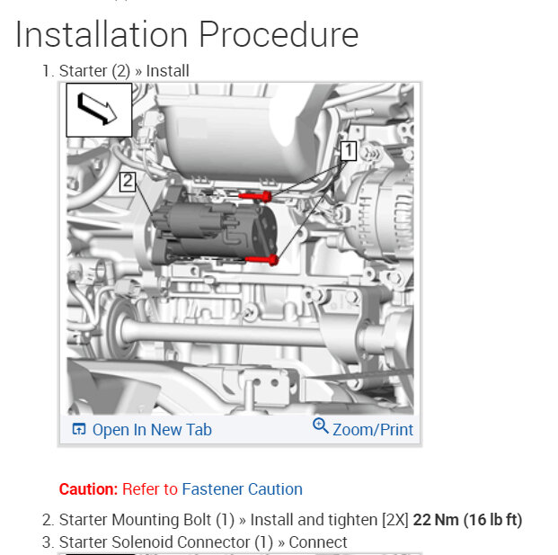

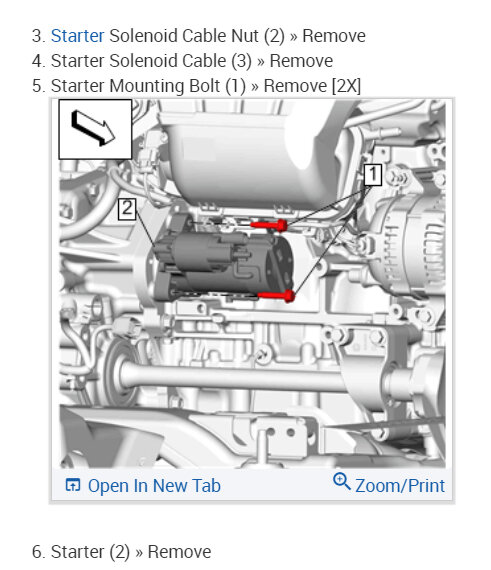

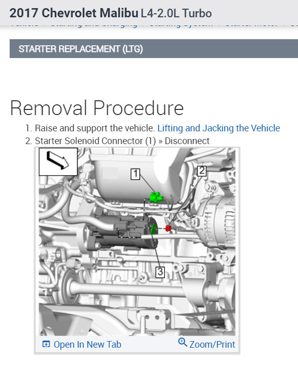

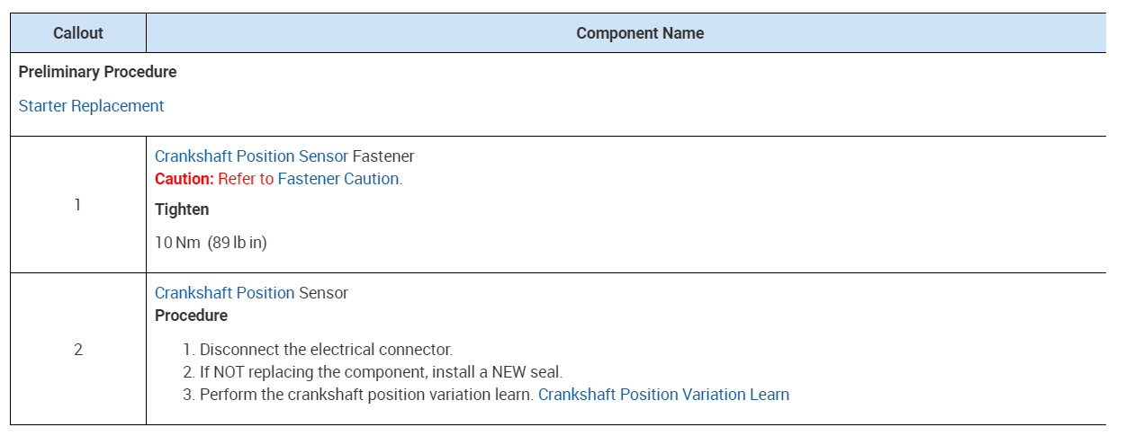

Here is the location of the crankshaft position sensor which is on the right side of the engine behind the starter motor. To begin, disconnect the negative battery cable to power down the system. Check out the images (below). Please let us know if you need anything else to get the problem fixed.
Aug 15, 2023 at 10:42 AM

Thank you, I did find it and was able to replace it, I have another question on the same vehicle, it coded p00CA high pressure fuel regulator high voltage, could you tell me what that means, do I need a new fuel pump or is there something electrical?
