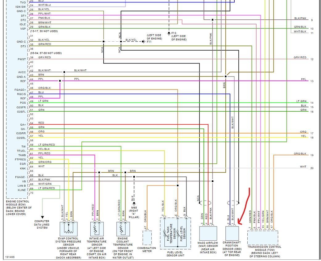

Need the crankshaft position sensor wiring diagram for the harness.

Sure here is the wiring diagram for the crankshaft sensor. Check out the images (below). Let us know if you need anything else.
Image (Click to enlarge)
