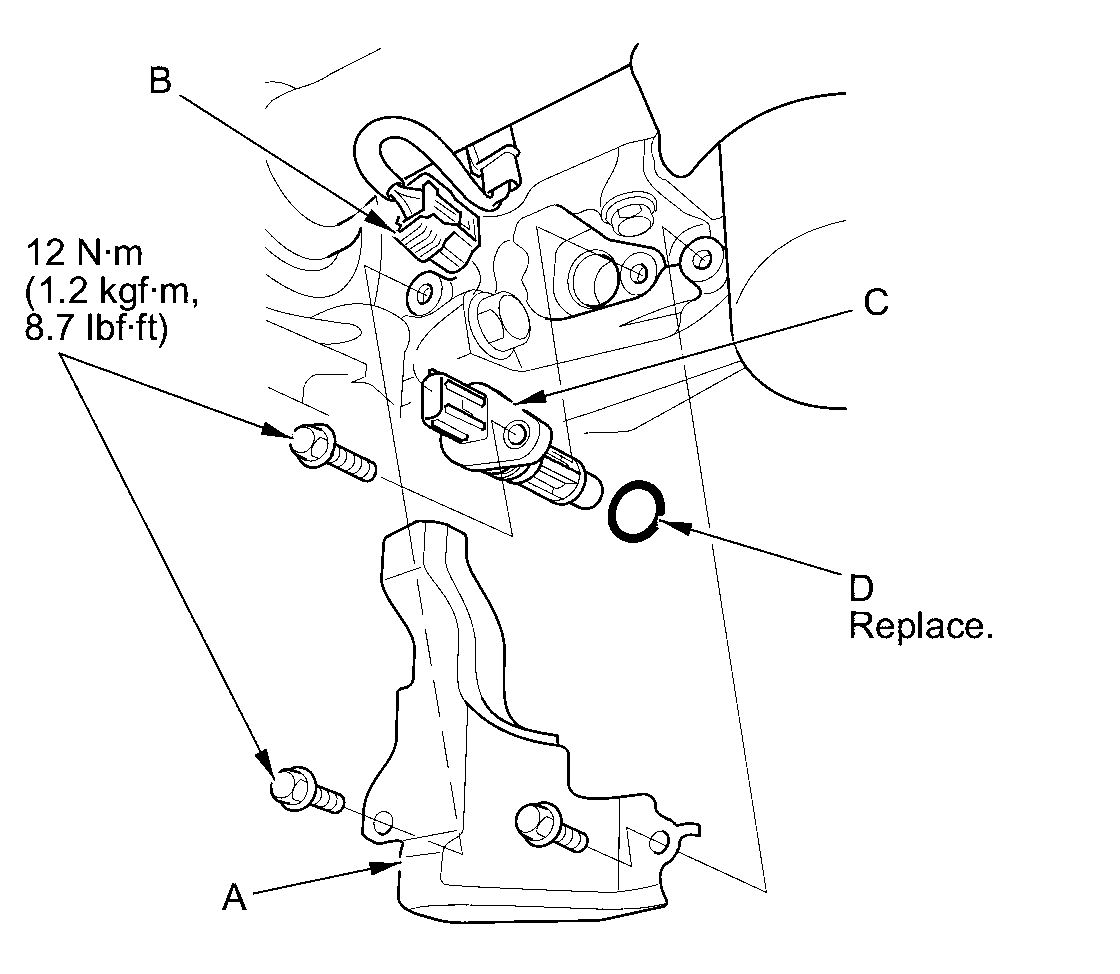

Here are the directions for replacing the sensor. Take a look through them to see if you missed anything. However, chances are you didn't.
________________________
2011 Acura TSX Sedan L4-2.4L
CKP Sensor Replacement
Vehicle Powertrain Management Sensors and Switches - Powertrain Management Sensors and Switches - Computers and Control Systems Crankshaft Position Sensor Service and Repair Removal and Replacement CKP Sensor Replacement
CKP SENSOR REPLACEMENT
1. Raise the vehicle on a lift.
NOTE: Make sure the vehicle is level, because engine oil will drip out when you remove the sensor.
2. Remove the CKP sensor cover (A).
pic 1
3. Disconnect the CKP sensor connector (B).
4. Remove the CKP sensor (C).
5. Install the parts in the reverse order of removal with a new O-ring (D).
_____________________________

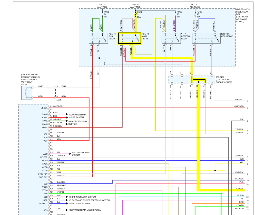

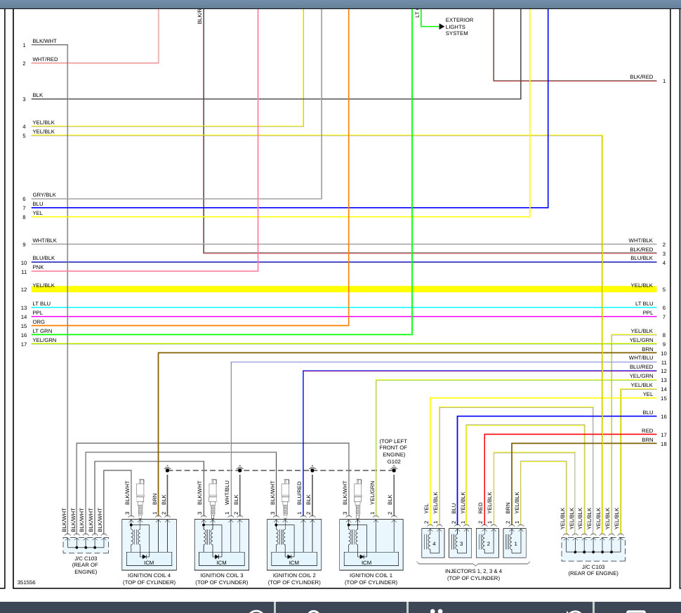

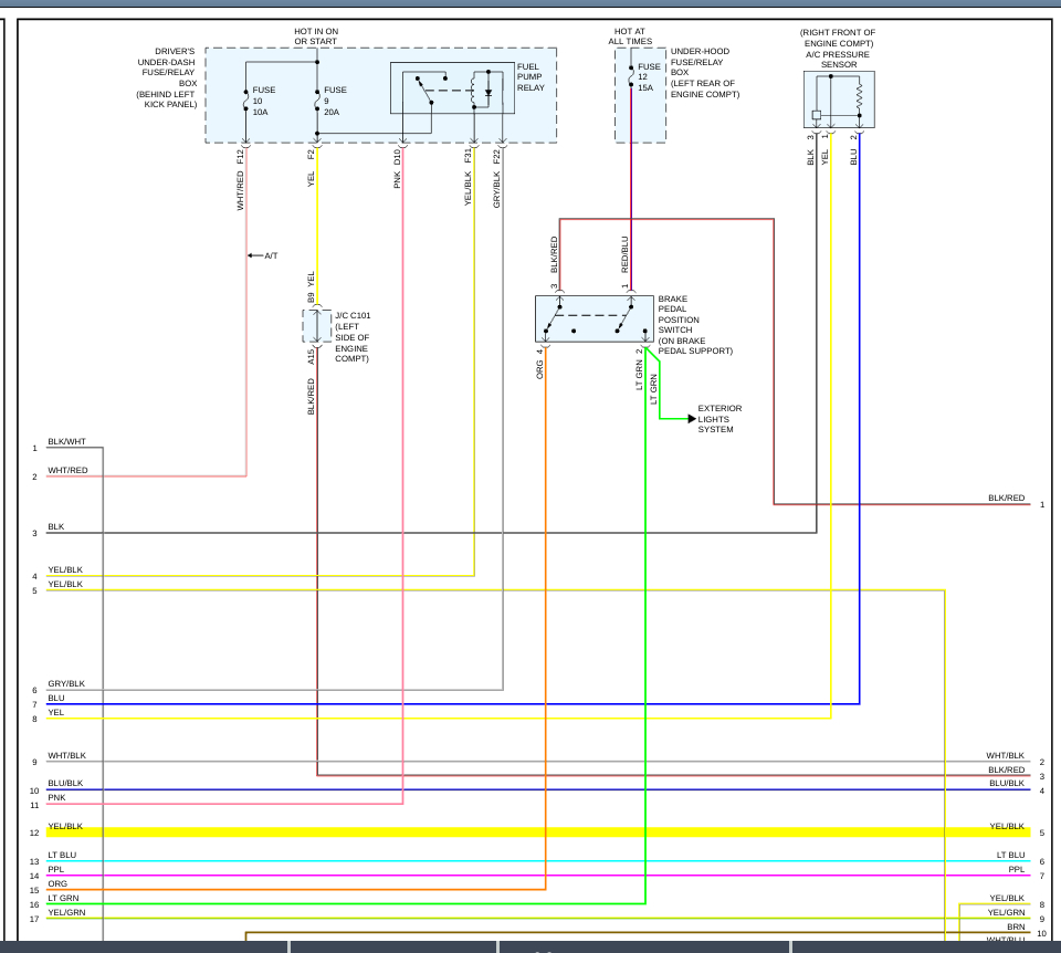

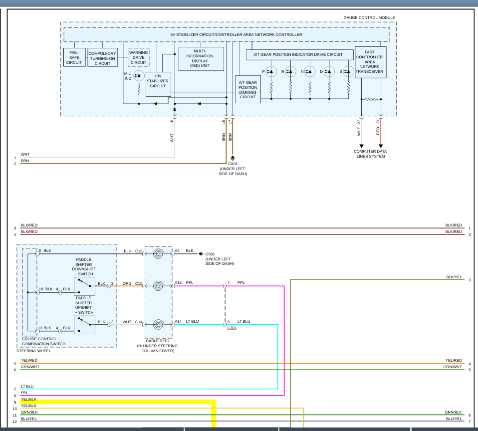

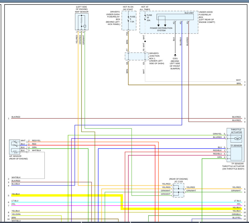

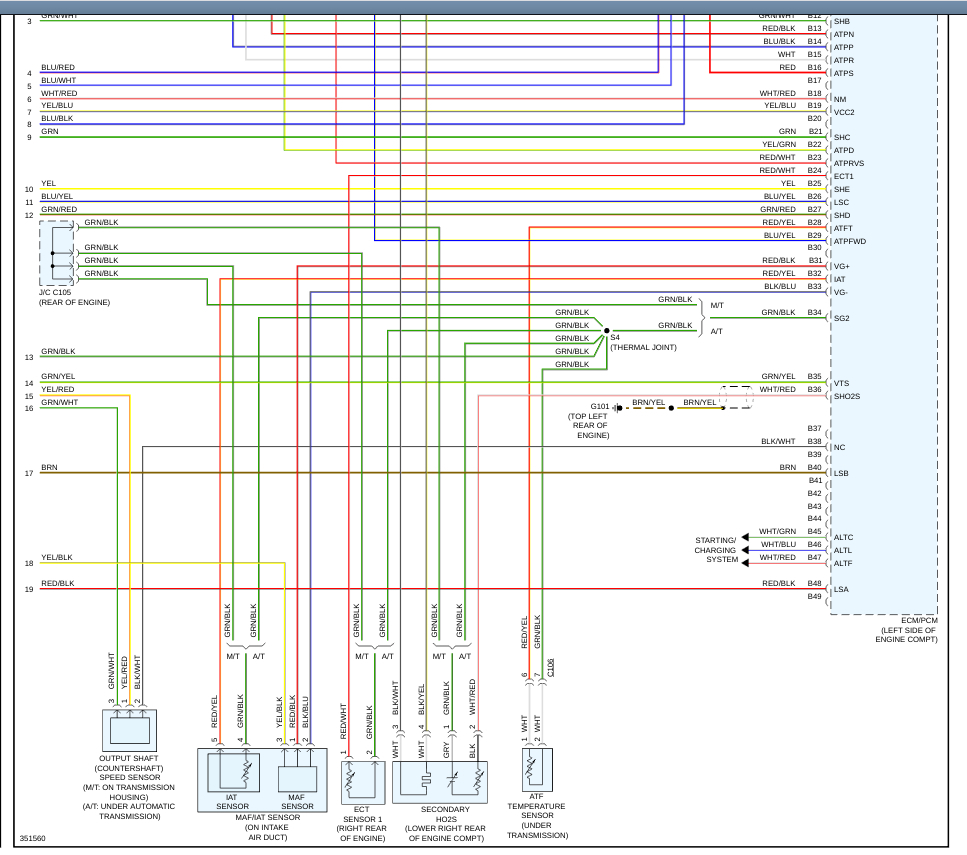

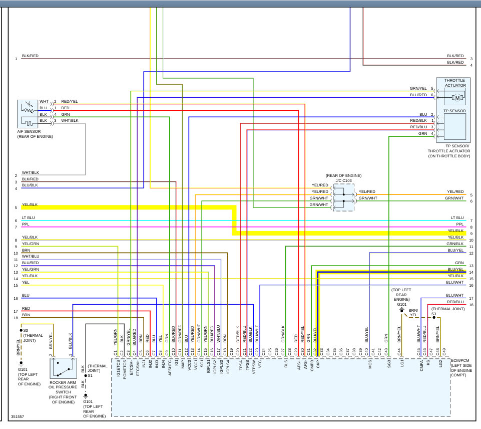

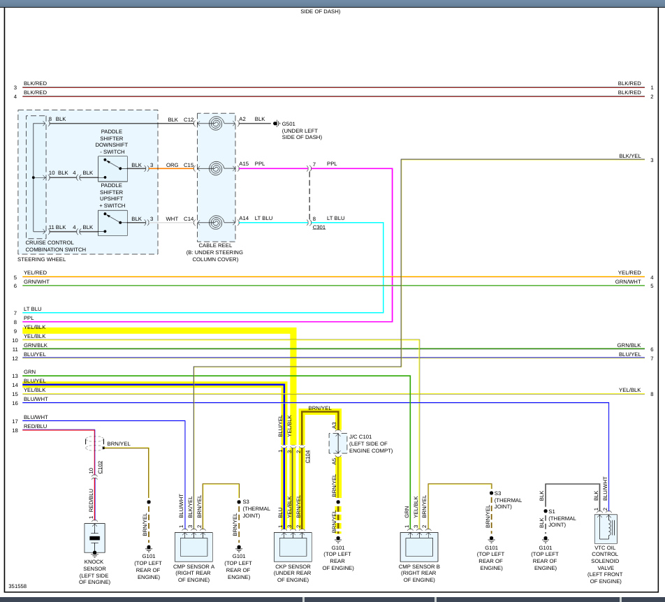

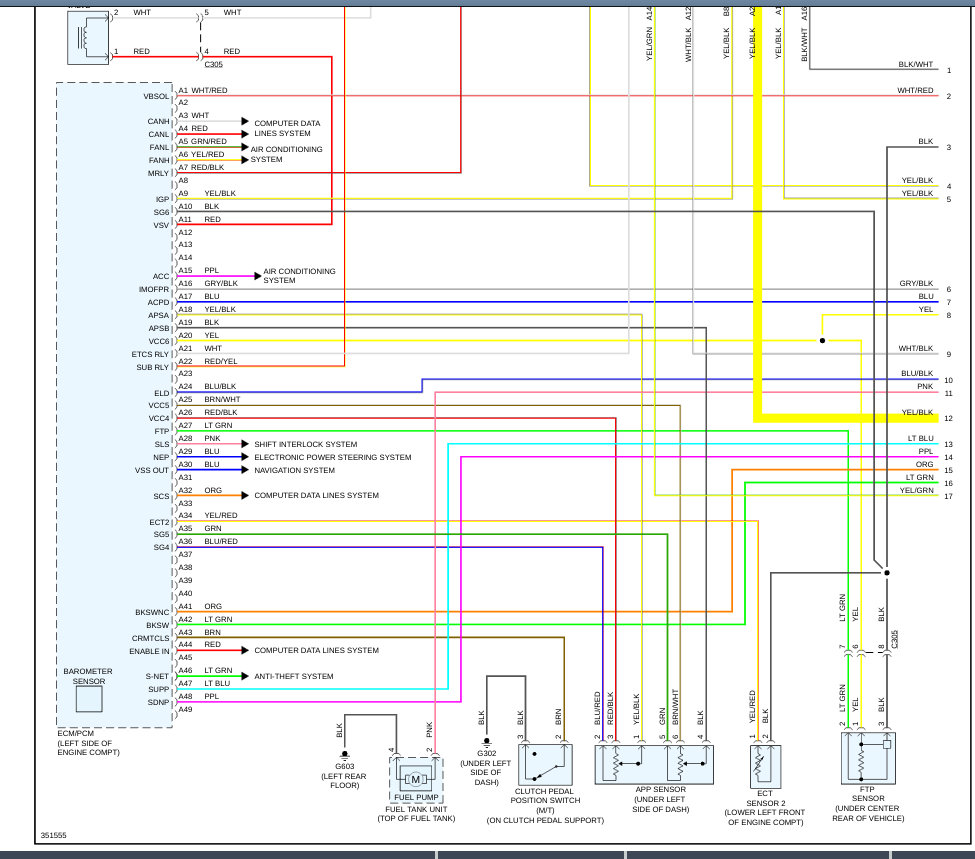

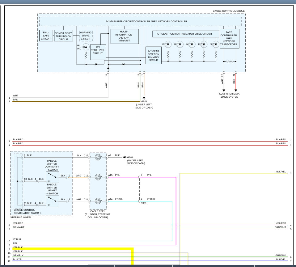

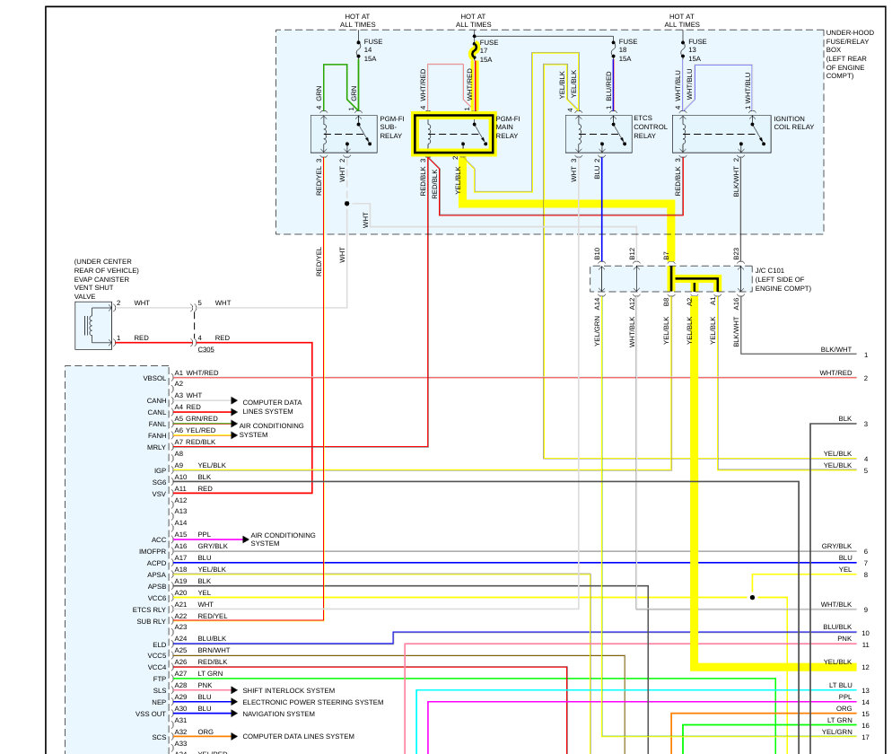

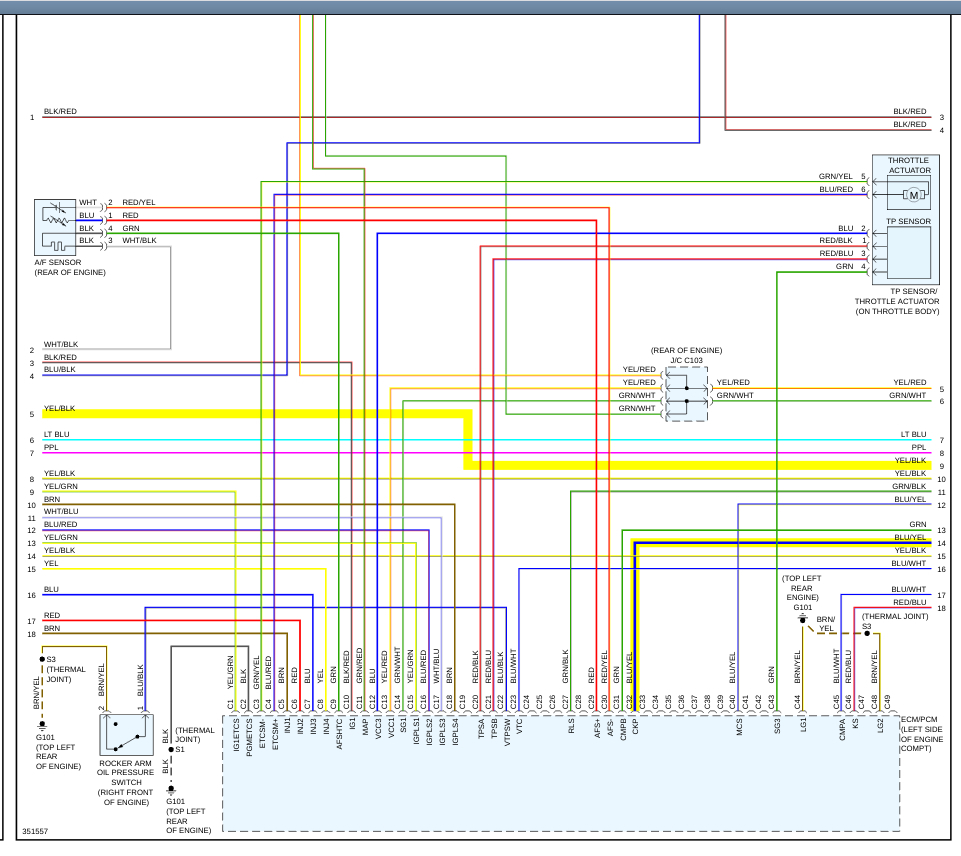

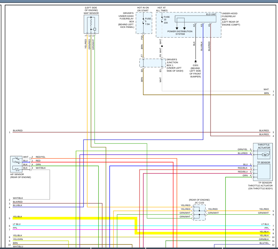

It could be a connection issue here is the engine wiring diagram and a guide to help check the connections.
Check out the diagrams (Below). Please let us know what you find.
Jan 25, 2020 at 9:17 PM
