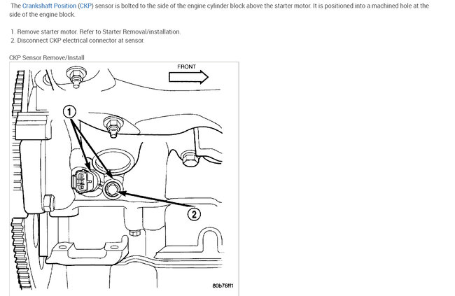

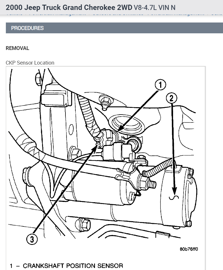

My car quit running I because of the symptoms started maybe the electric fuel pump I've changed it, and it still won't start. it turns over smoothly but won't crank. I'm thinking crankshaft position sensors my next fix and going through the process of elimination. I don't know where to find it on the vehicle and how easy it is to access.
Jul 4, 2023 at 11:26 AM

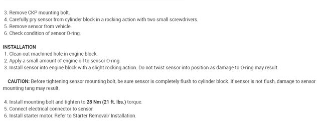

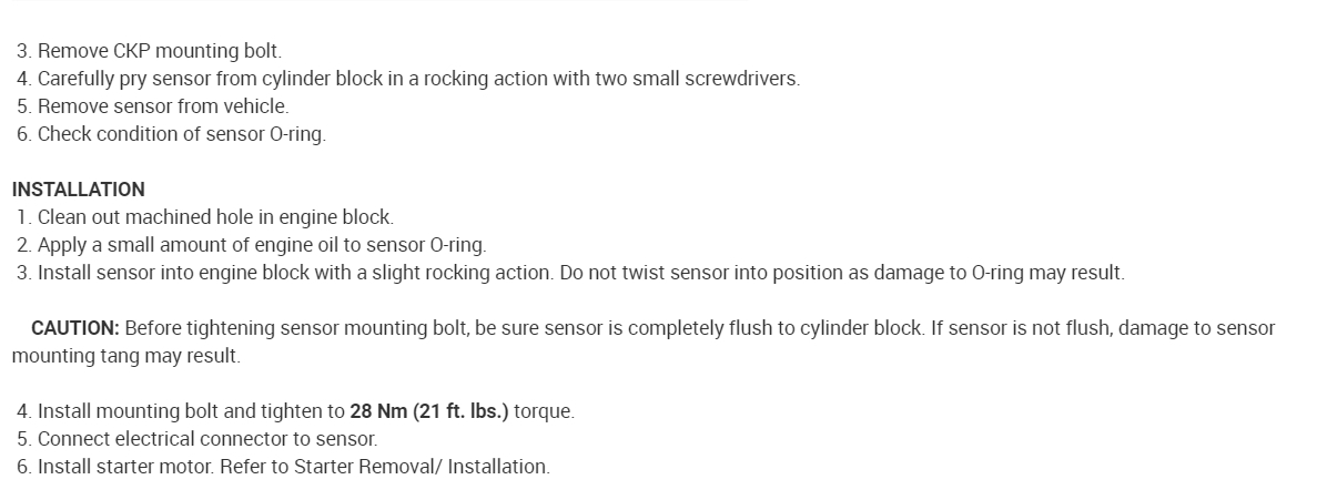

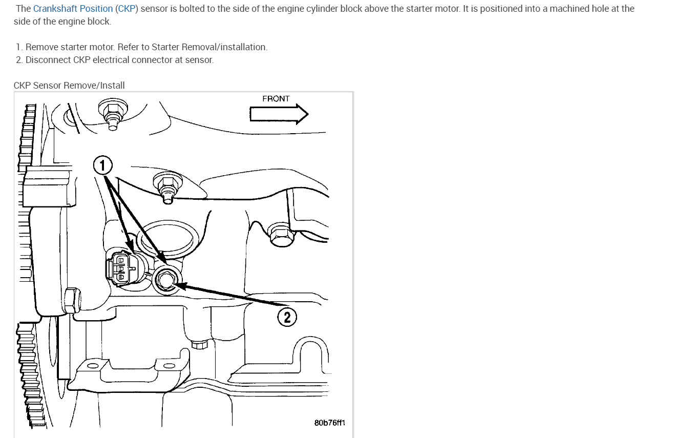

the crankshaft sensor is near the starter motor here is how to change it out. Check out the images (below). Please let us know if you need anything else to get the problem fixed.
