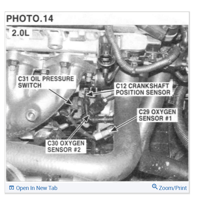

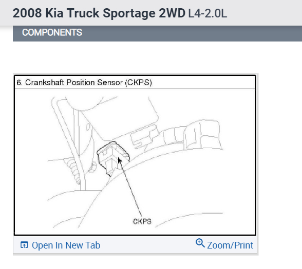

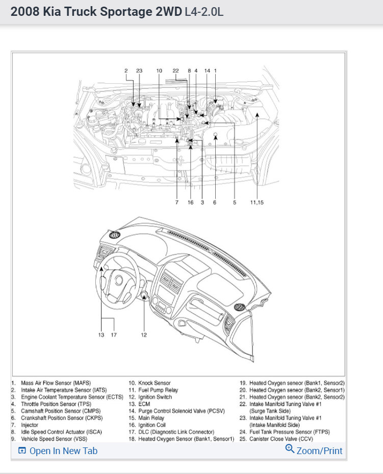

The crankshaft position sensor is near the radiator hoses., here is the exact location and how to change it out in the images below. Check out the images (below). Please let us know if you need anything else to get the problem fixed.
