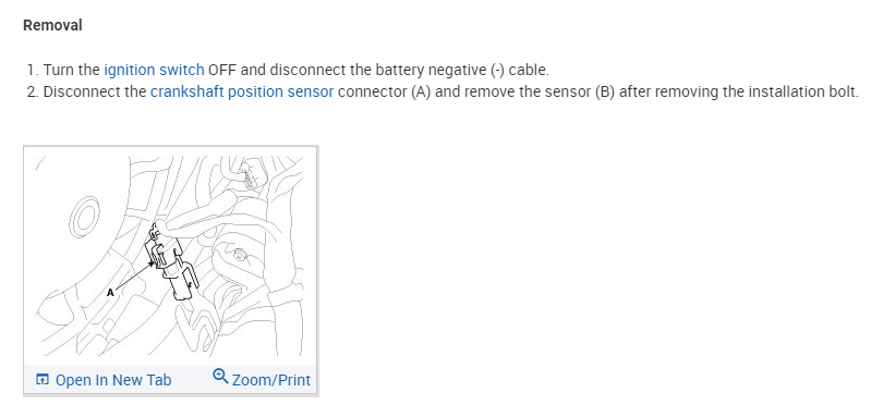

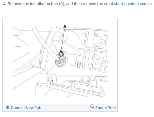

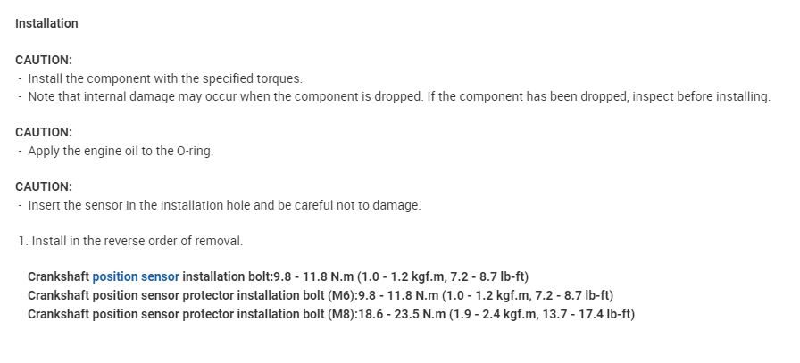

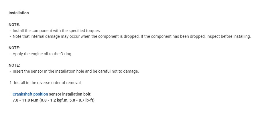

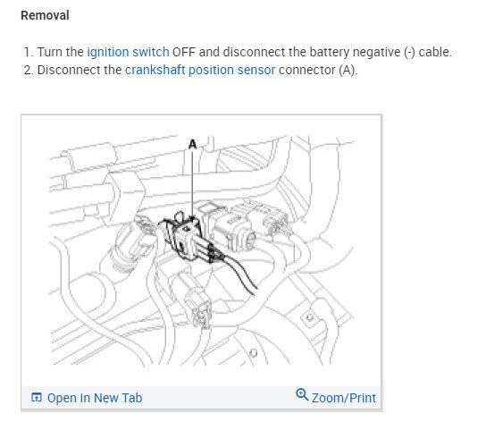

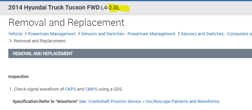

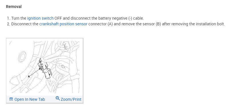

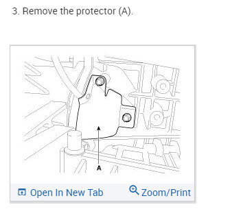

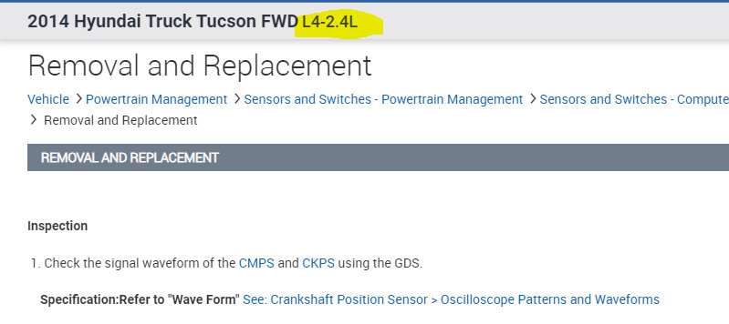

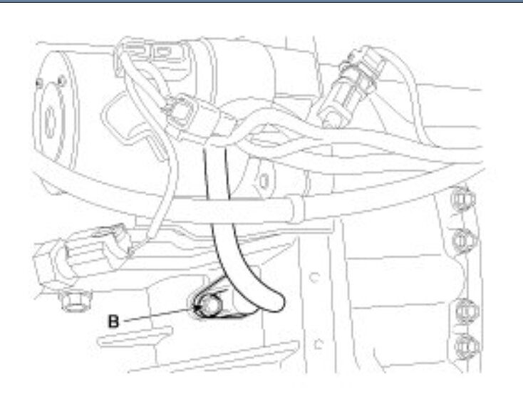

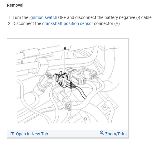

I am only showing a 2.0L or a 2.4L four-cylinder engine as options. The 2.0L is below the starter motor and the 2.4L is at the rear of the engine block near the transmission bell housing.
I attached directions for both engines below. I highlighted the engine size at the start of each procedure.
If you have a V6, let me know.
See pics below.

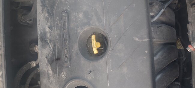

OZIAS LEVI ISRAEL
Yes, it's a v6 engine.
Nov 25, 2022 at 3:05 AM
OZIAS LEVI ISRAEL
Sorry, it's a 16v engine.
