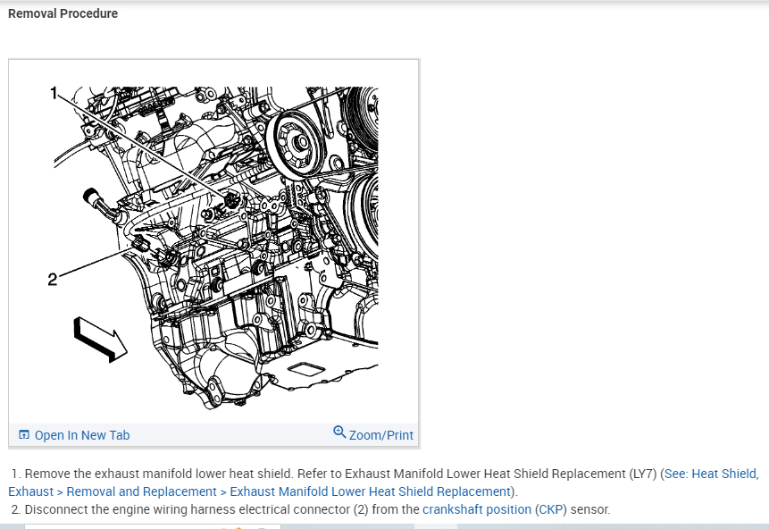

Where is the Crankshaft position sensor located?
2009 CHEVROLET MALIBU
170,000 MILES • 3.6L • 6 CYL
CEASEAR COLLIER
Where do I find the location, do you guys have a diagram?

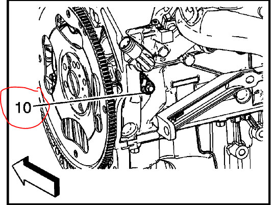

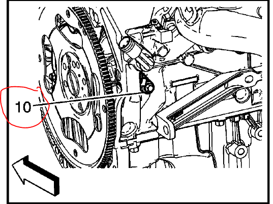

If you look at pic 1 below, it shows the location. It is toward the rear of the engine on the side.

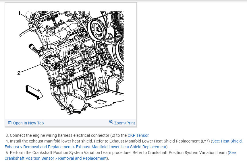

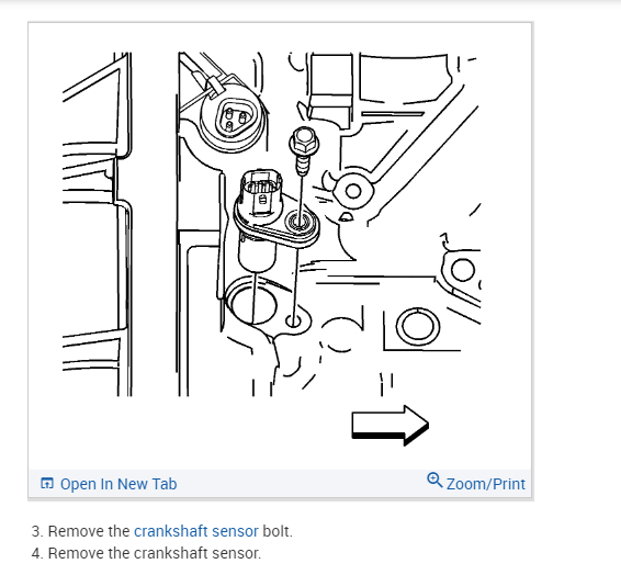

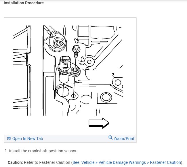

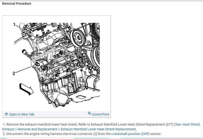

Additionally, I attached the directions for the removal and replacement of the sensor. I don't know if you need them, but I figured I would add them.
joe
See pics below.
