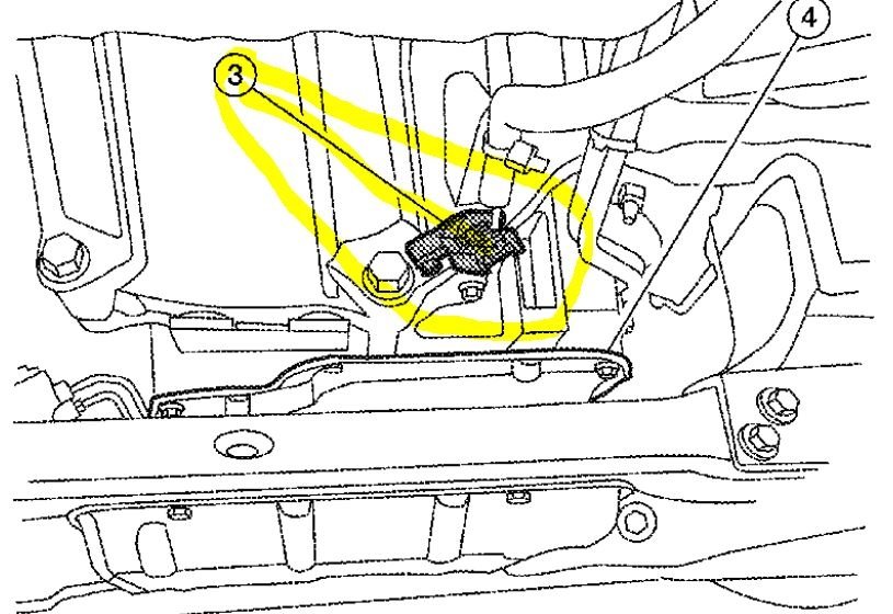

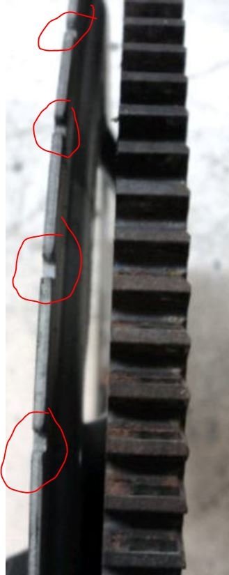

It is underneath the rear of the engine in the bellhousing flange. It reads the notches on the plate next to the starter ring gear. Replacement is simple, go under the vehicle, remove the retaining bolt and the wire connector, install the replacement part and connect the harness connector. What is the vehicle doing that makes you think it needs replacement?

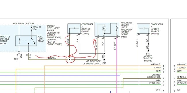

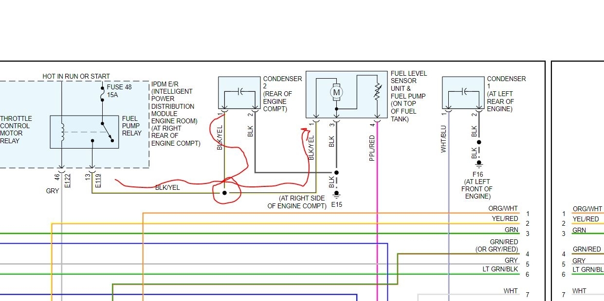

Another way to test if it was a control issue would be to bypass the pump controls, for that you need to find the condenser that is on the fuel pump lead it is at the back of the engine compartment and will have a black wire with yellow stripe and a black wire. If you pull the connection and jumper battery voltage to the black and yellow wire it will power up the pump. If you do that in the way that it normally doesn't start and now it starts without the 5-10 second pause you have a lack of pump control signal. That could be a bad ECM or bad pump relay. Just more free testing to track down an issue.

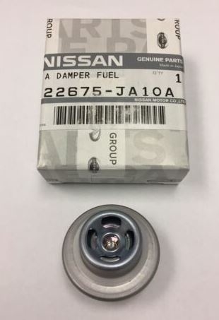

It is a returnless system but it still has a regulator. The primary is in the tank with the pump while the other is what Nissan calls a damper assembly. Looks like the item below.
