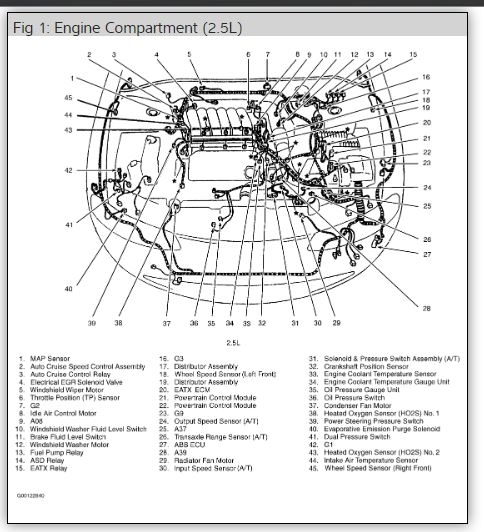

Where exactly is the crankshaft position sensor located on the vehicle listed above ES model?

The crankshaft sensor is located in the bell housing on your car, I have attached a diagram showing you the location. Hopefully this will help you out. Thanks for using 2CarPros
